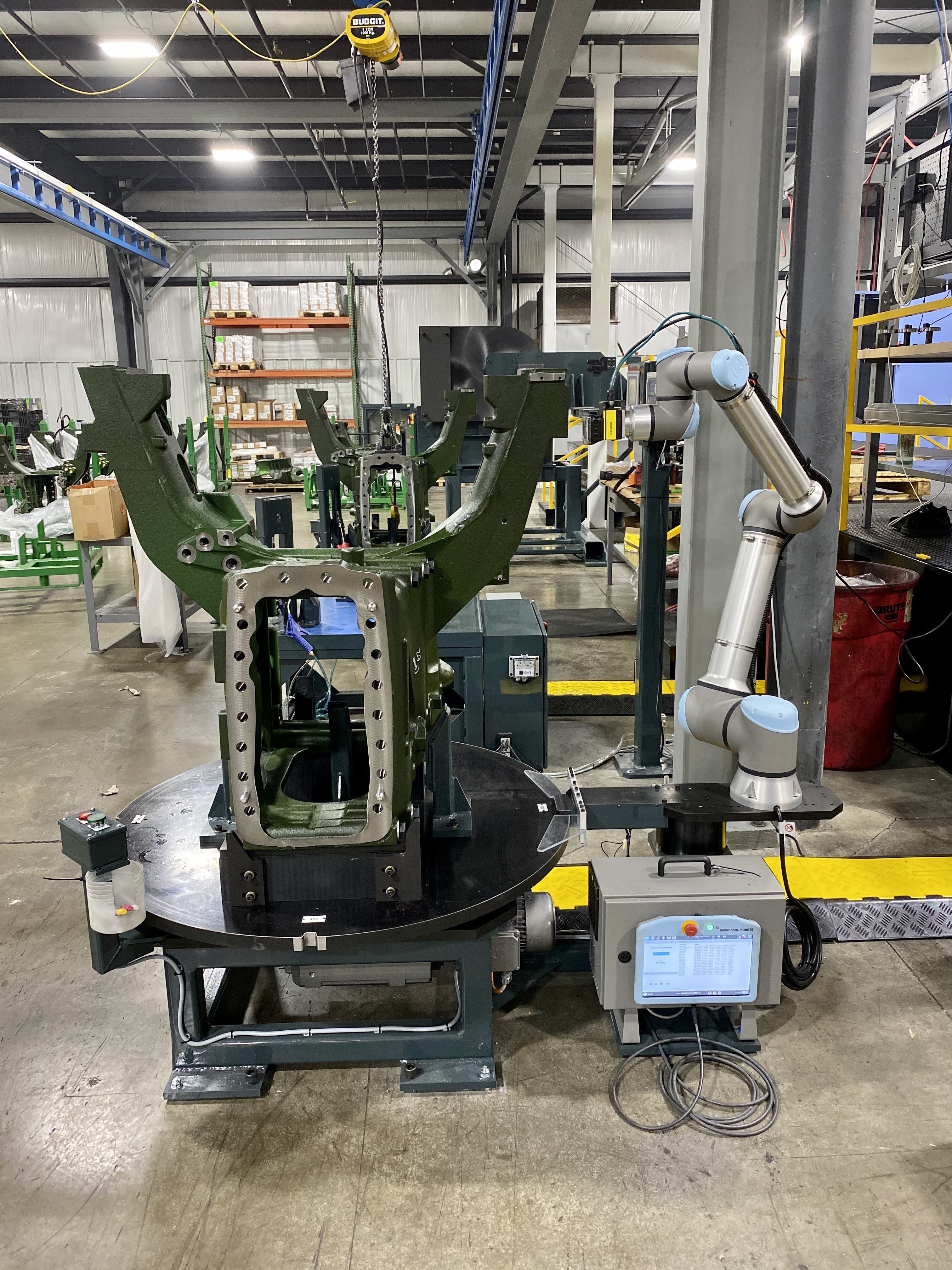

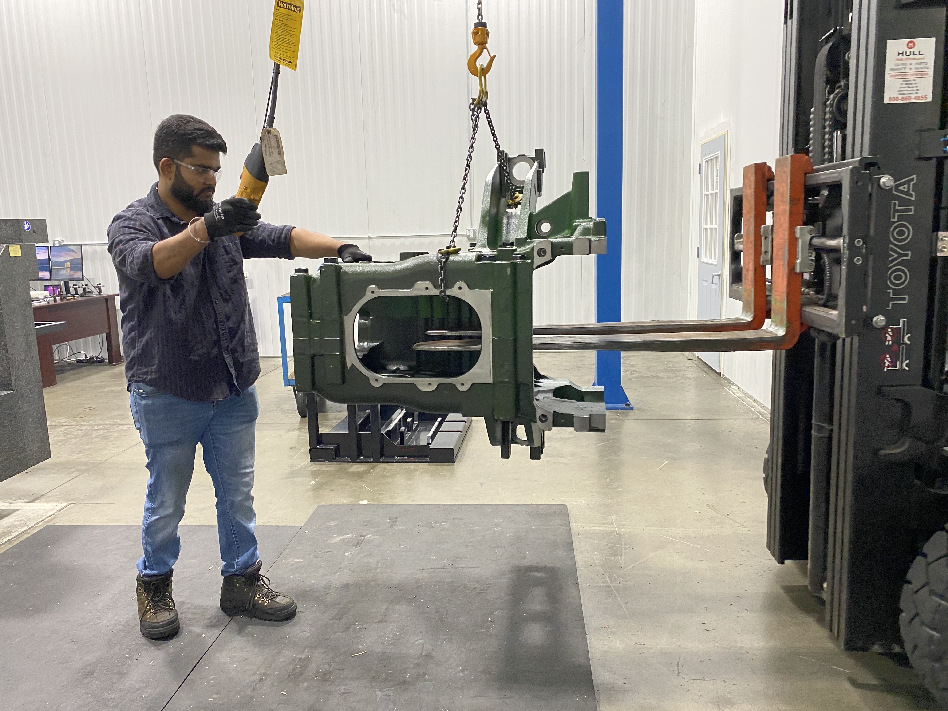

The company’s latest purchase from Doosan was based on a bid from a major agricultural manufacturer for the production of the mid-frame for a tractor. According to Jerry, “It's basically one of the first components required when producing the vehicle.” It involves the machining of two 500-pound castings made of ductile cast iron that are bolted together and then machined again. This results in a 1,000-pound casting, which requires a big 800mm size horizontal machining center.

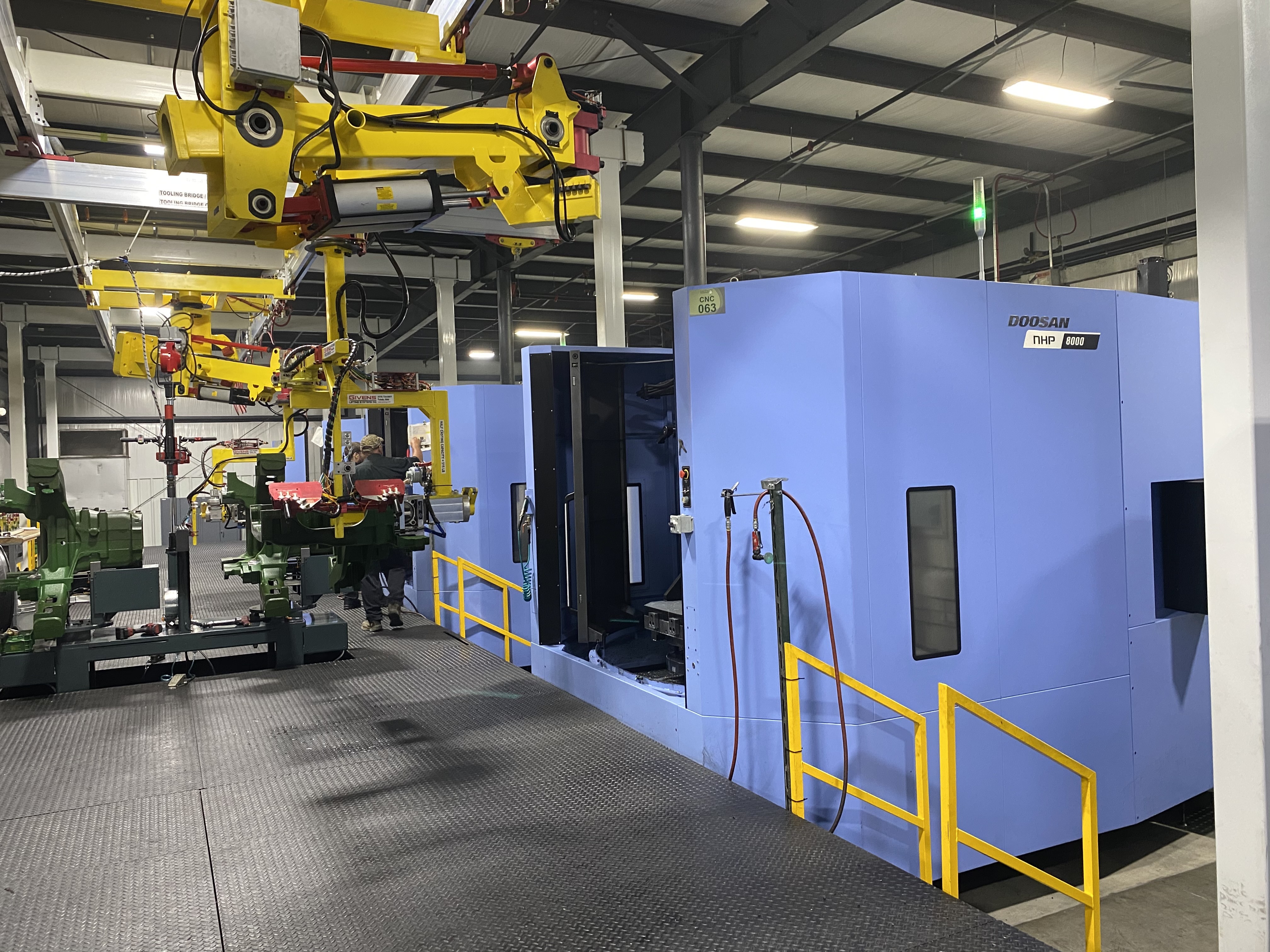

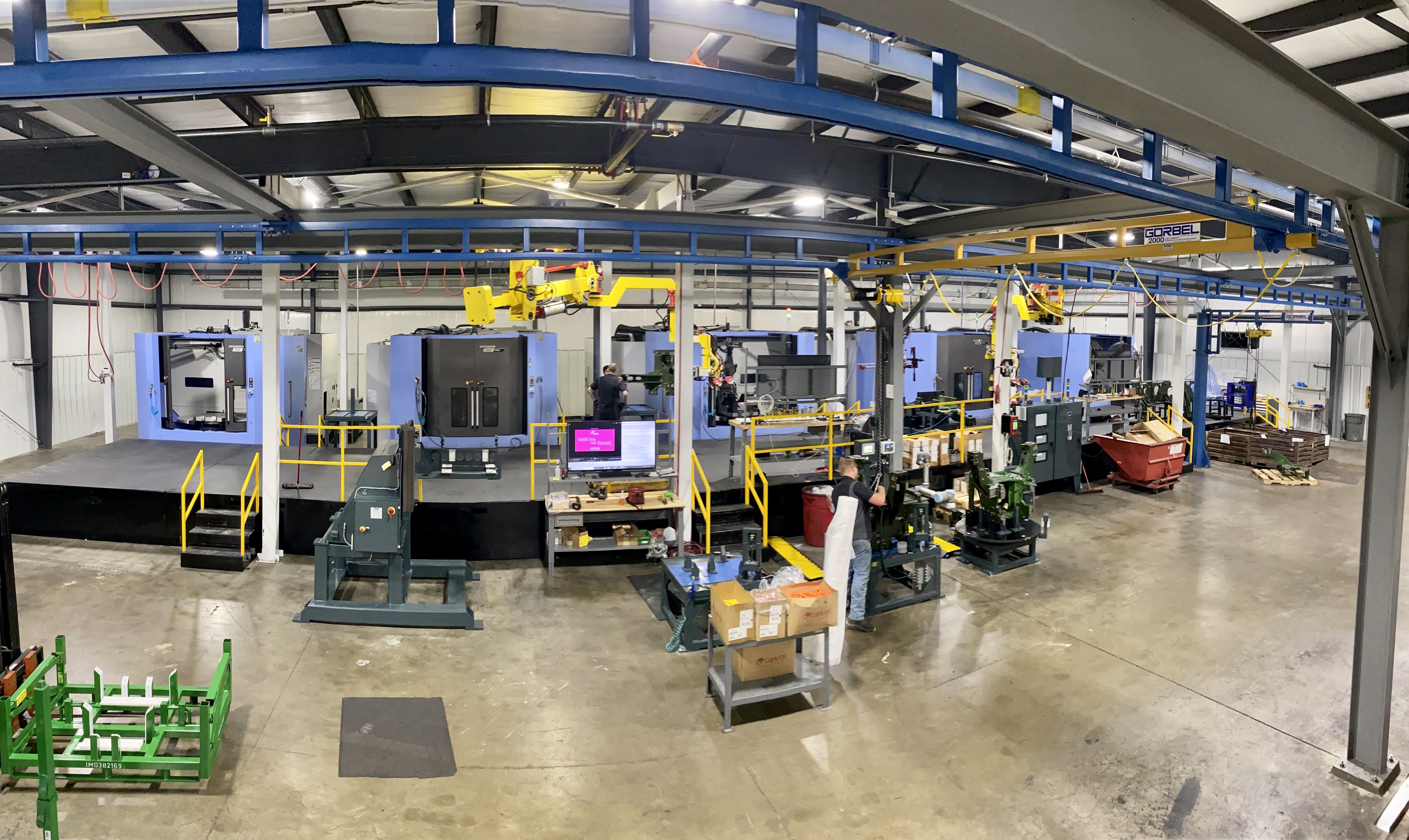

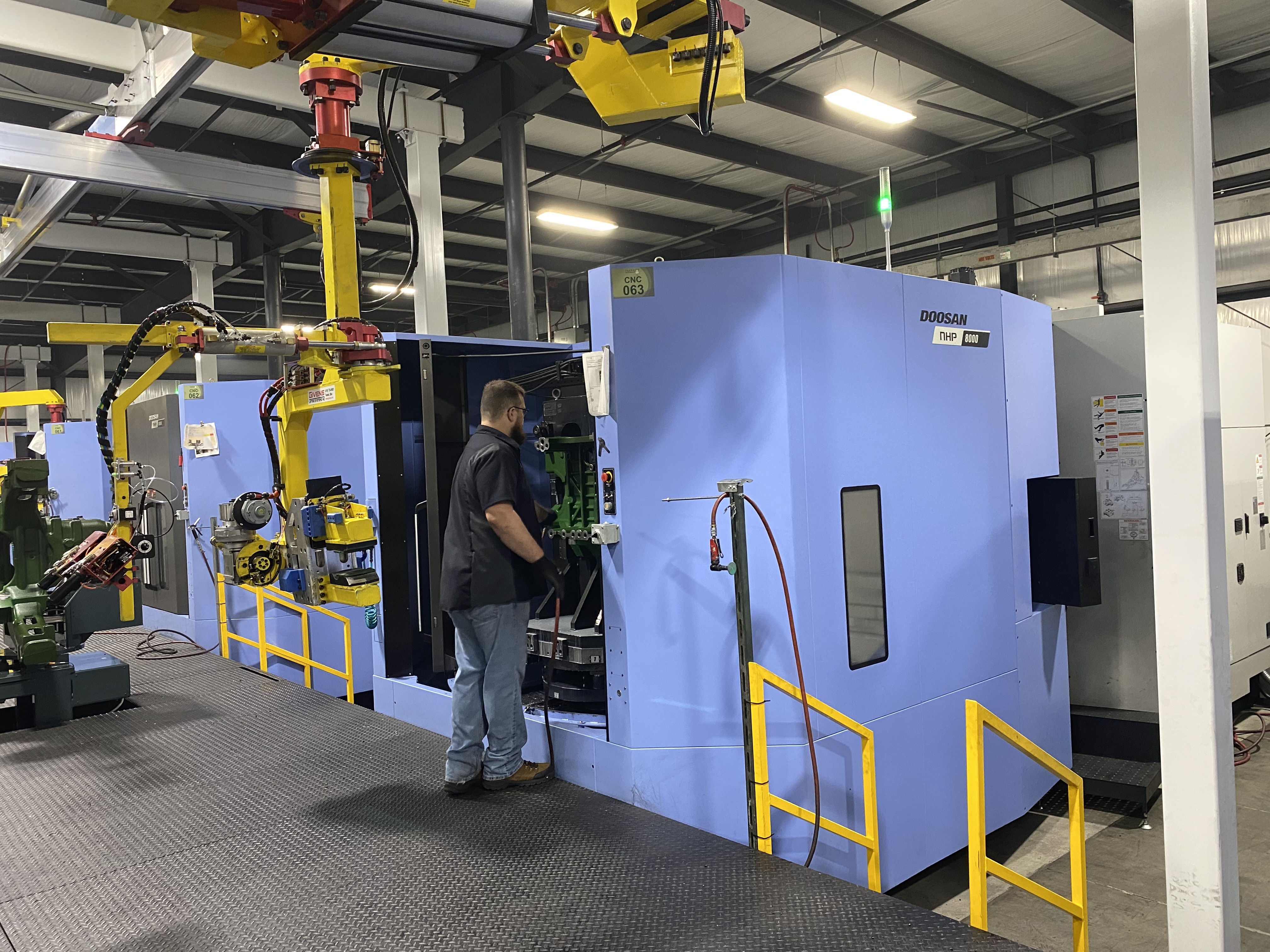

While still in the fine-tuning stage, Jerry says the newest Doosan machines in the shop are living up to the standards Impact CNC has come to expect. They have two NHPs machining the 550 lb casting halves, two more that machine those castings once they're assembled (1,000 lbs), and a 5th machine as a spare. PDQ (a well-known custom workholding company) built all the hydraulic fixturing so those machines have constant connection hydraulics, a big advantage in any high-volume production environment. In that five-machine line is also a clean out station and leak test station, not to mention a cobot vision inspection station and laser barcode process for full validation/traceability.
