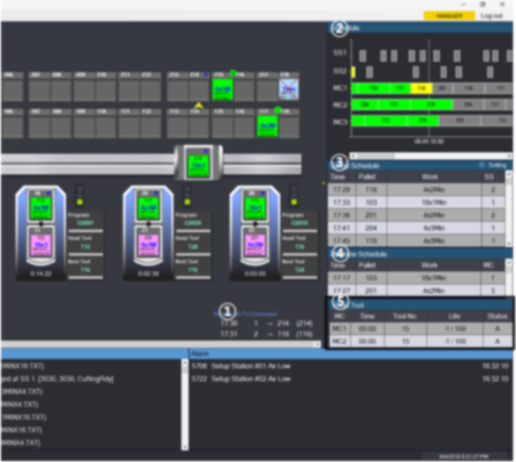

① Menu bar
Performs major functions of DPMS
② Work list
Displays the progress of pallets (from the list)
③ PC OP panel
Conducts AGV automatic operation
④ System layout
Visually displays pallet and station information
⑤ Message
Displays AGV operation log and alarm messages

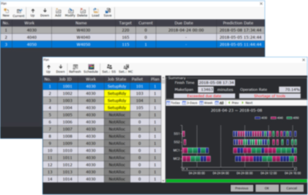

Manage production plans
- Inputs and revises production plans
- Creates jobs and work programs according to the schedule
- Checks overdue delivery, tool shortage, capacity utilization rates, etc.

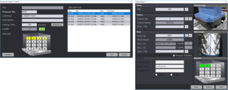

Group parts support
- Supports 16-part program per pallet and offset program registration/entry
- Enables skip setting of parts registered in the initial setup
- Supports part unit count

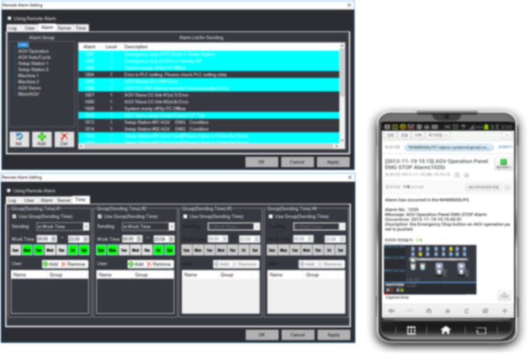

Remote alarm
- During unmanned operation, if the alarm is generated an email is sent allowing a quick response to the situation.
- Alarm to be sent, the recipient, alarm time, etc. on the setting screen can be selected- Show the required amount of tools by machine to enable tool preparation

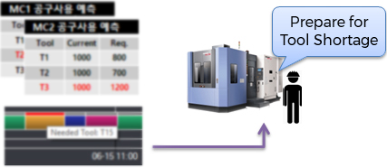

Schedule preview
- During automatic operation, the system generates specific scheduling and operating information for the worker preparation
① Next AGV move
Predicts and displays 2 transfers after AGV

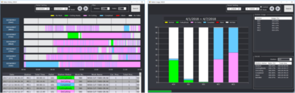

② Schedule chart
Displays setup and machine schedules by chart
③ Setup schedule
Displays pallet transfer schedules by setup
④ Machine schedule
Displays schedule of pallets transfers to the machine
⑤ Short tool
Displays tool information that is expected to have insufficient tool life

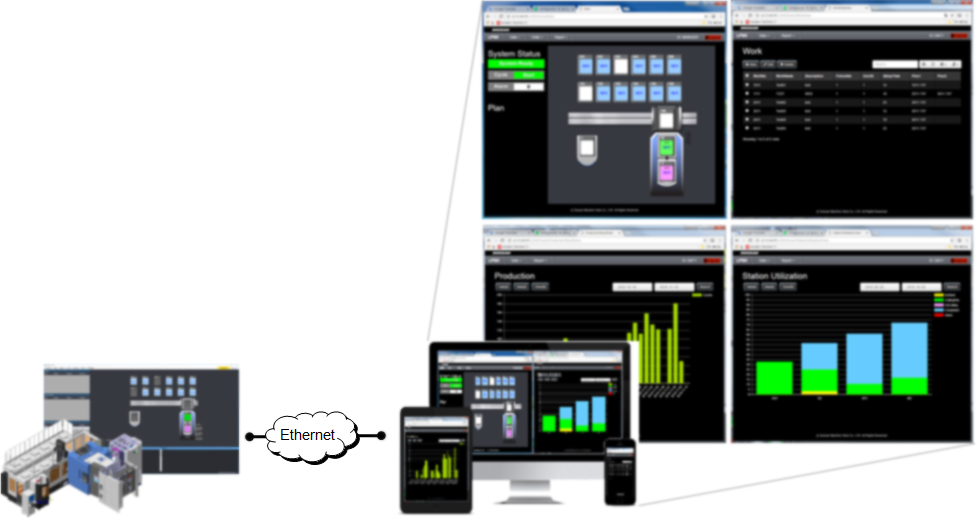

Remote DPMS
- Web-based DPMS monitoring system
- Checks LPS status remotely via the web
- Registers program, work and plans remotely

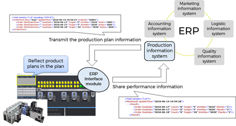

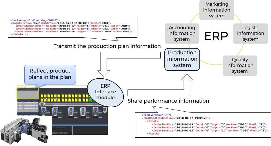

ERP interface
- Function designed to allow the sharing of information between existing systems (ERP, MES, etc.) and the DPMS
- Supports the input of production plans and the output of production results through file sharing, library provision etc.
