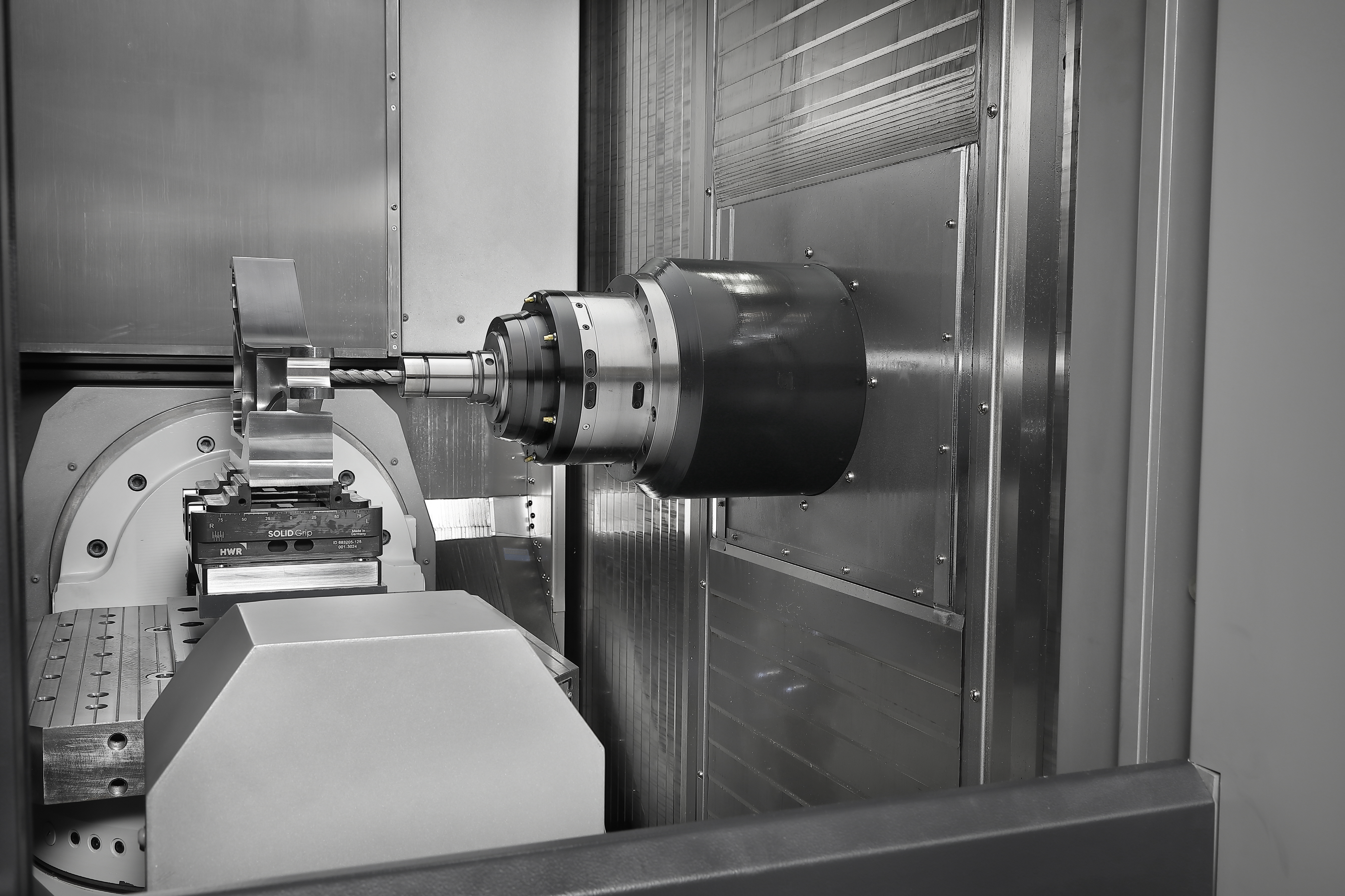

Highly reliable 5-Axis Horizontal Machining Center that delivers stable machining performance
This horizontal machining center features a high-rigidity structure based on a horizontal spindle combined with a tilting rotary table, delivering stable machining performance and great reliability even in heavy-duty cutting environments. In addition, its high-precision positioning control and thermal deformation suppression technologies ensure consistent quality in the machining of complex geometries.
Heavy Duty Cutting of Large Workpieces
￿ Simultaneous 5-axis machining with exceptional precision
High-speed built-in spindle: 15,000 / 20,000 / 30,000 r/min
Simultaneous 5-axis machining: Siemens SINUMERIK ONE

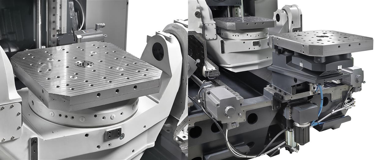

Tilting table structure for multi-angle machining in a single setup: -180° to +45°
￿ Continuous machining of medium to large parts
Maximum size of workpiece: Φ900 × H760 mm
Pallet size: 630 × 630 mm
Servo-driven automatic pallet changer (APC)

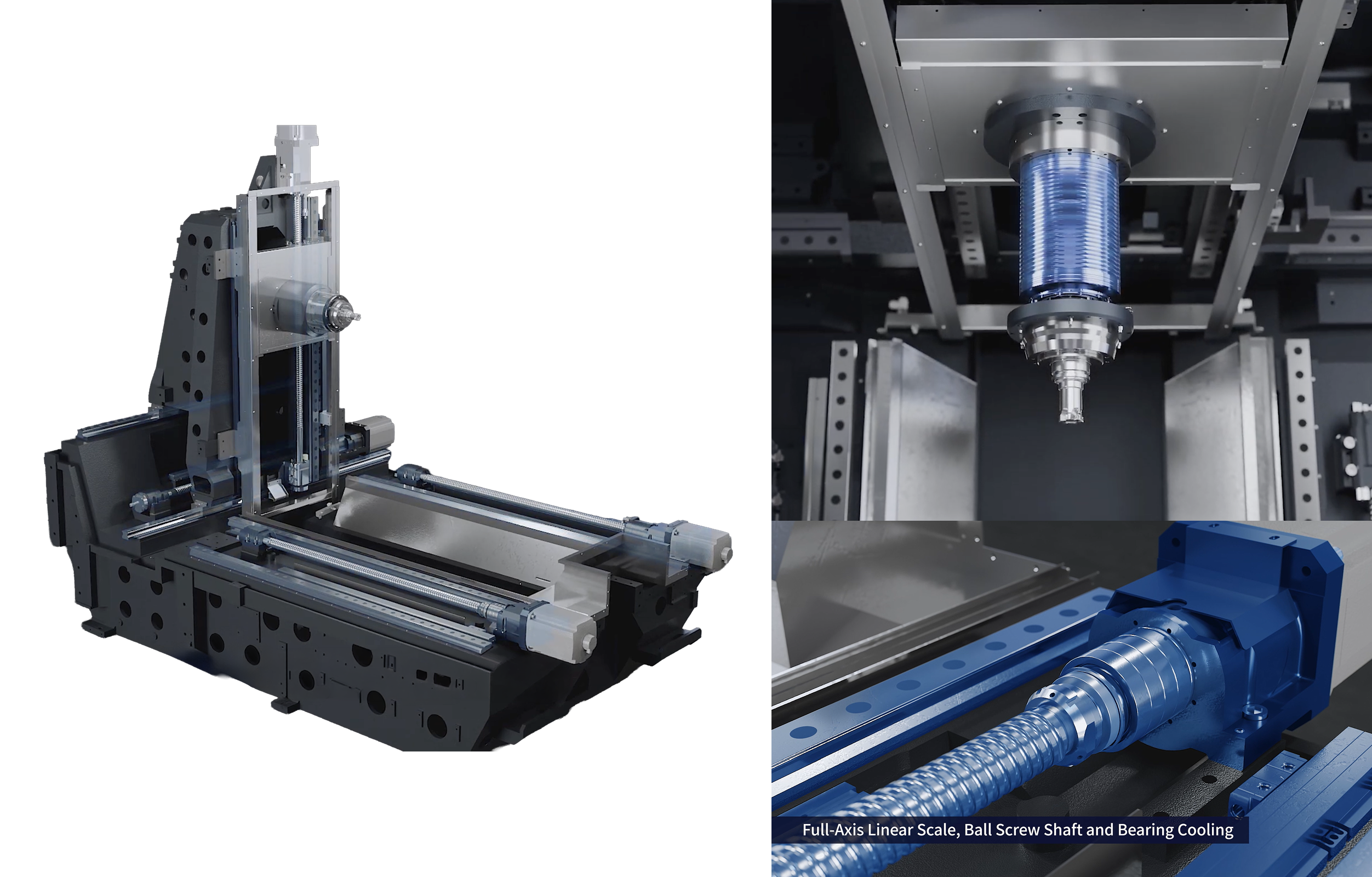

Stable performance for prolonged machining
All axes are equipped with linear scales.
The Z-axis is fitted with dual ball screws.
Features a ball-screw shaft and nut cooling system.
