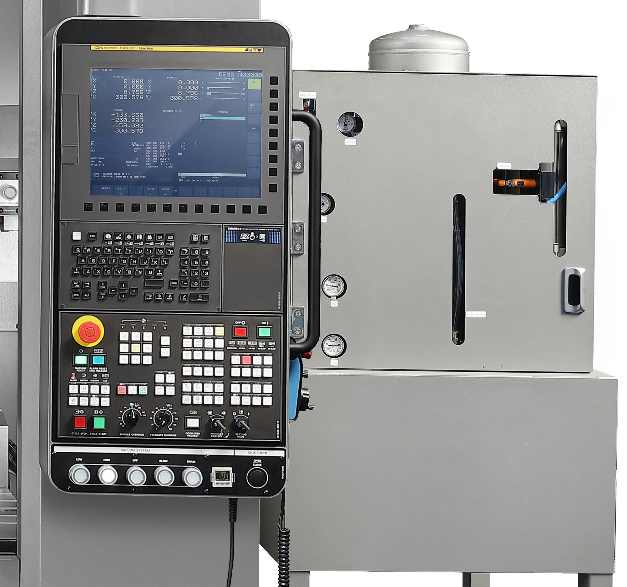

Optimized Ceramic Machining with Vacuum Unit
Easy Workpiece Setup
Choose between high- and low-pressure vacuum levels to conveniently clamp workpieces.
Auto Drain Function
Automatically evacuates coolant from the vacuum unit during extended machining runs, ensuring uninterrupted operation.
Air Blow Function
Rapidly releases the vacuum via air blow to reduce workpiece removal time, while automatically purging debris from the lines, keeping your workflow efficient.

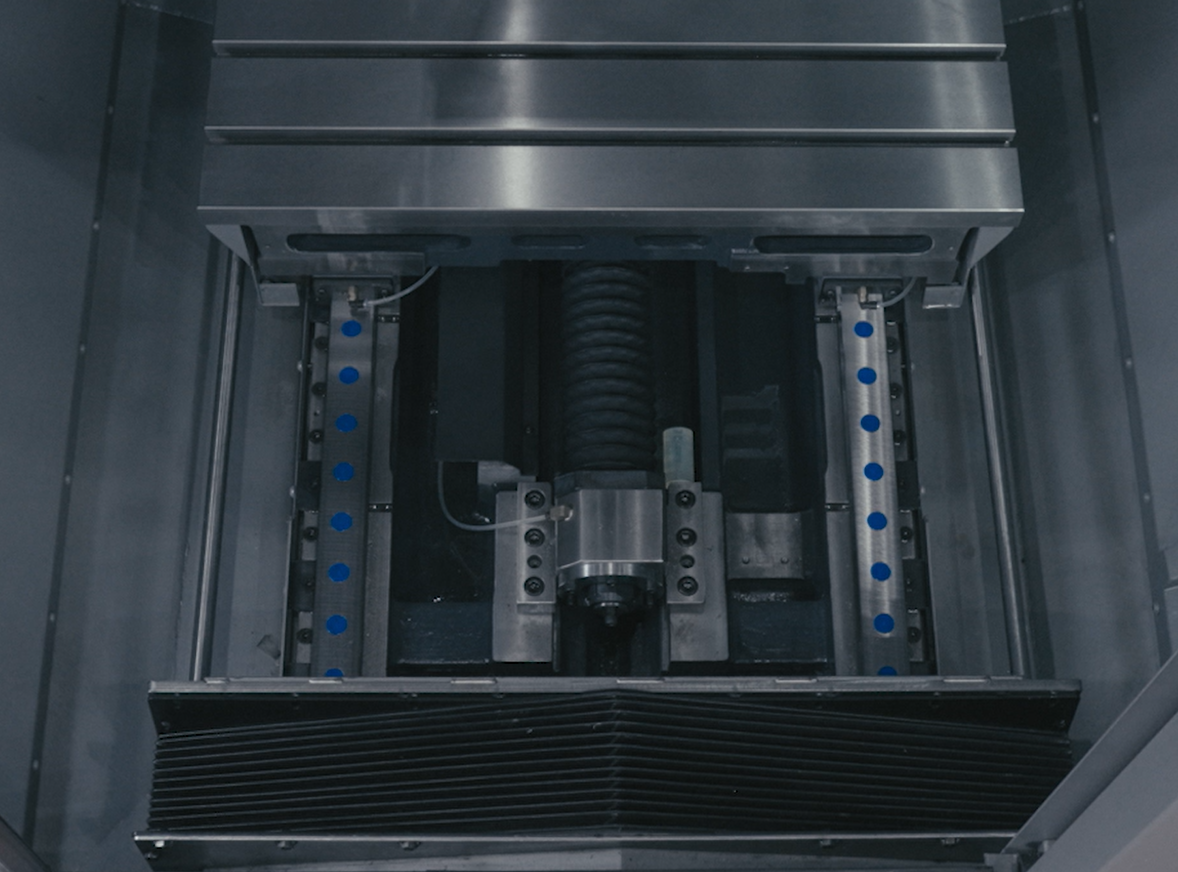

Enhanced Durability with Feed System Protection Package
Bellows covers, ball screw covers, and double-wipers on the LM guides work together to effectively block fine chips from entering critical components. By protecting the core feed axis components, the machine maintains long-term machining quality with improved durability and reliability.

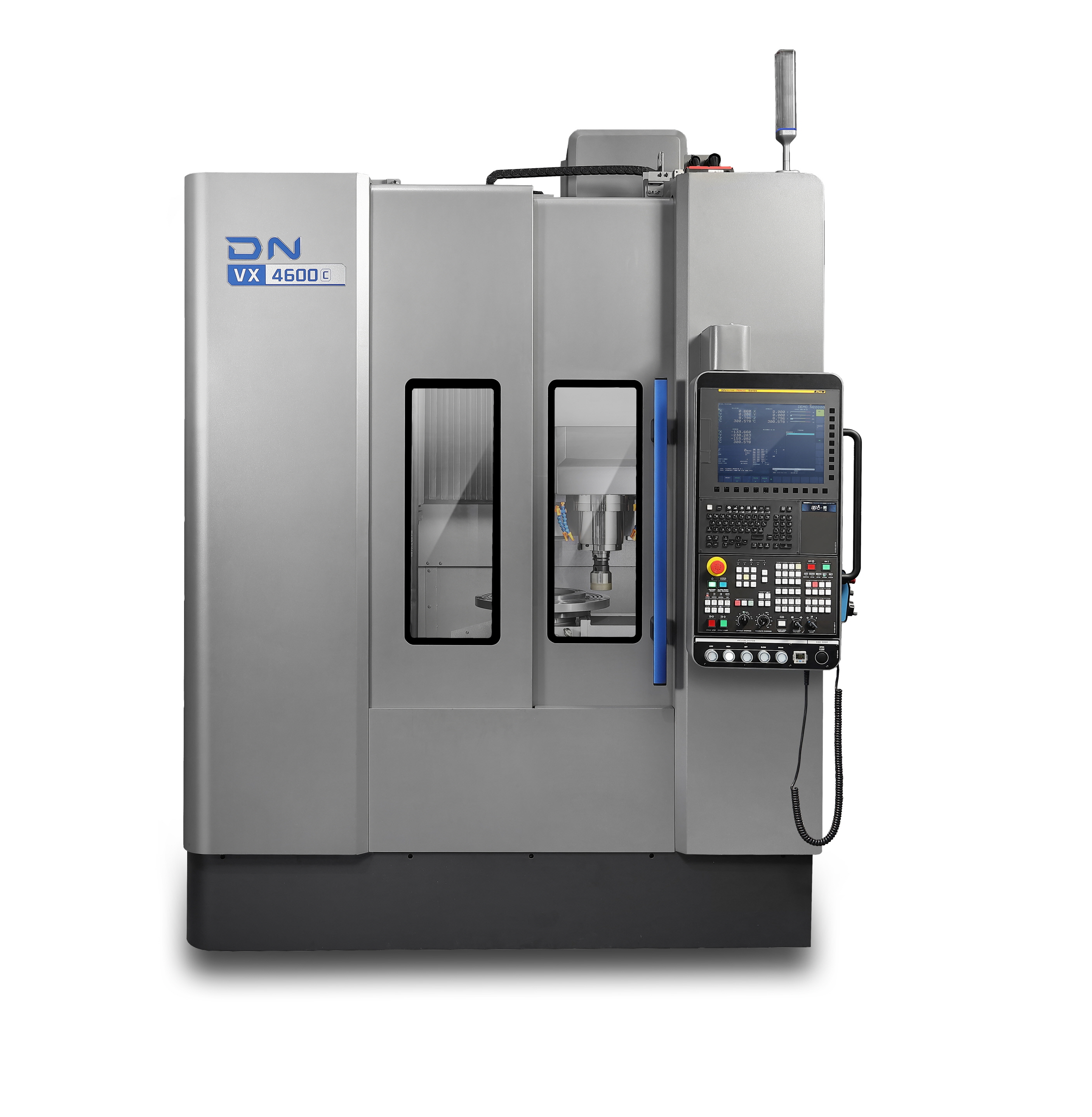

Minimal Footprint, Maximum Usability
At just 2m wide, one of the most compact in its class, the machine maximizes floor space efficiency, allowing more units per production line and optimizing your capital investment.
A wide door opening of up to 800mm improves operator access and setup convenience, keeping productivity high.

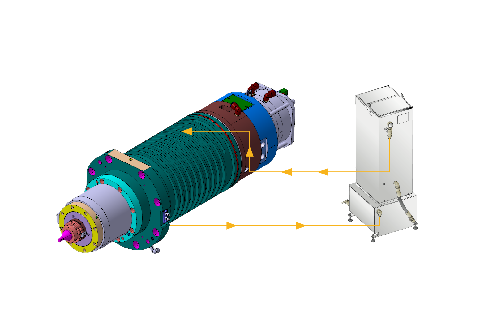

Ball screw and spindle cooling systems are also included as standard to prevent thermal deformation.
