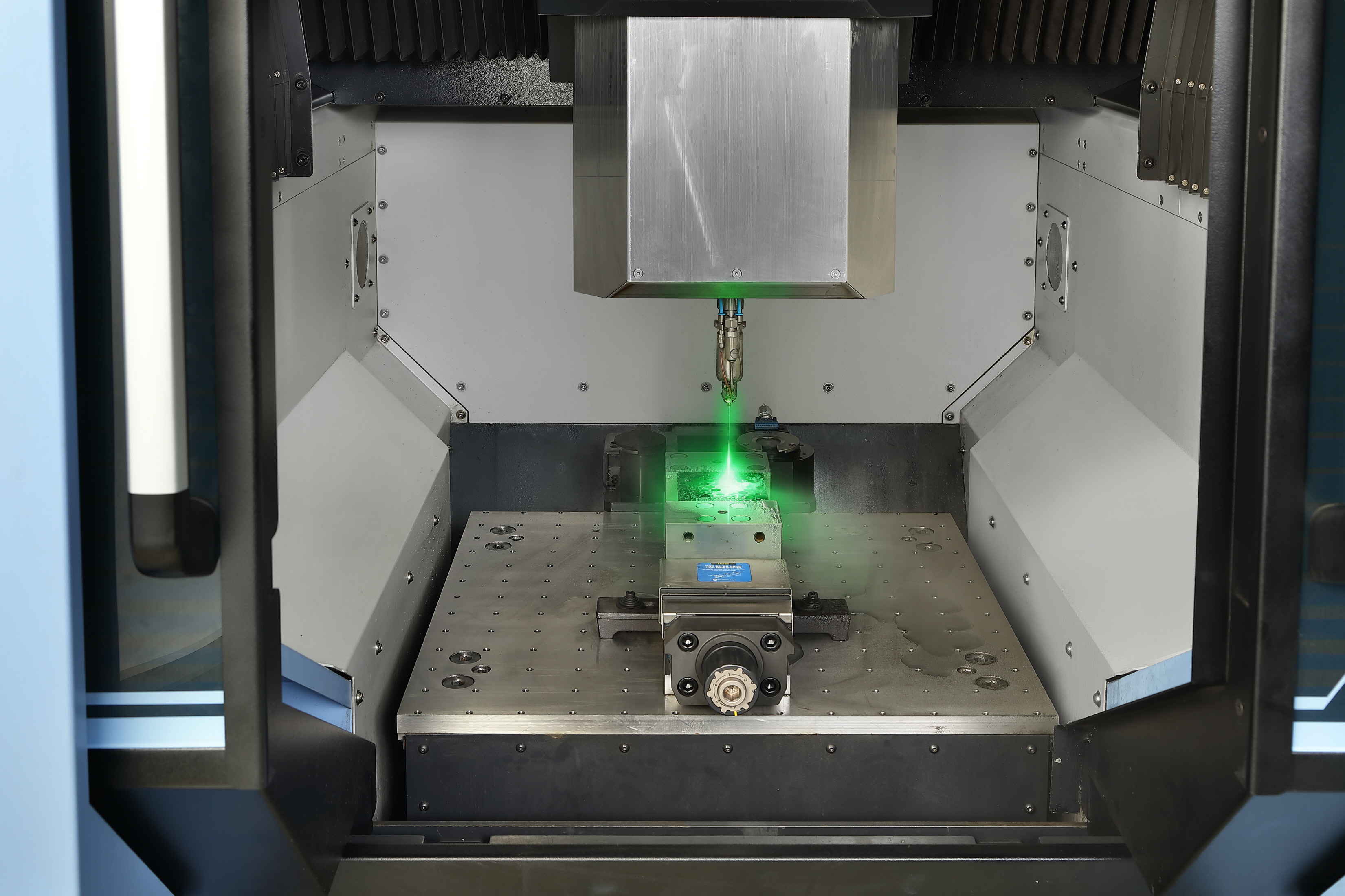

Processing Solution Combining the Advantages of Laser and Waterjet
A convergence solution that brings together the high productivity of laser processing and the stability of waterjet technology. By processing with a parallel laser beam, laser control is made more convenient, while the properties of water reduce heat-affected zones and maintain excellent surface quality.
Various Cutting Applications
￿ Convergence Processing Solution￿
Combines the strengths of both laser processing and waterjet technology
Parallel laser beam guidance eliminates the need to control laser focal distance
Ultra-thin water stream cools the cut surface and removes burrs
Ideal solution for processing high-hardness and high-strength materials
