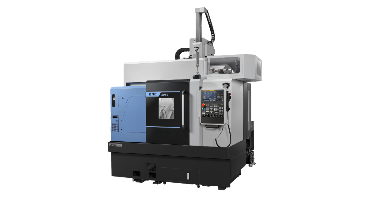

DNC 8050
810 mm
DNC series
Ceramic & Quartz Grinding machine
DNC seires are Horizontal Turning Center with Grinding and Machining function in one machine which is optimized for ceramic and quartz machining and easy for automation.
Easy to Operate 使用便捷性
Shortened Machining Time 缩短加工时间
Easier Automation 易于自动化
亮点
￿ Excellent Machining Capability
￿ Various chucks equipable(12~20inch)￿
￿ Various option including Vacuum chuck or Built-in motor Available￿
￿ BP12/30 spindle motor￿
￿Hole machining and contouring available without machining center
￿ Premium quality grinding spindle
￿ designed by DN Solutions￿
￿ Max spindle speed 10000r/min, Max power 7.5kW￿
￿ BT40 Big plus and CAT40 Big plus Applicable￿
￿ Fanuc motor based DN Solutions in-house manufactured spindle ￿
￿ TSC option available￿
￿ Rigid machine structure
￿ & User friendly design￿
￿ Full cover structure for protecting the inside of the machine￿
￿ Easy cleaning coolant tank￿
￿ Servo motor equipped ATC(8 or 40 tools)
Auto tool inspection & Auto workpiece inspection applicable￿
产品规范
  • 本产品规范符合全球标准,各地区规范可能略有不同。
标配卡盘尺寸 最大车削直径
X 轴快移速度 Z 轴快移速度 X 轴行程 Z 轴行程
最大主轴转速 最大主轴功率
长度 高度 宽度 重量
研削主轴
最大主轴转速 刀具类型
DNC 8060
12 20 inch 810 mm
10 m/min 20 m/min 550 mm 650 mm
500 r/min 18.5 kW
2840 mm 2042 mm 2043 mm 3400 kg
10000 r/min BT40
DNC 8050
12 20 inch 810 mm
10 m/min 20 m/min 550 mm 550 mm
500 r/min 14.1 / 6.3 kW
2370 mm 2900 mm 2043 mm 3500 kg
10000 r/min BT40
