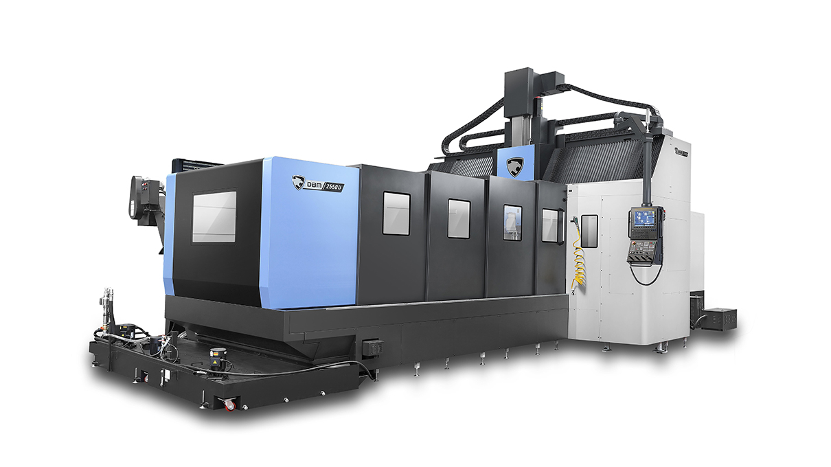

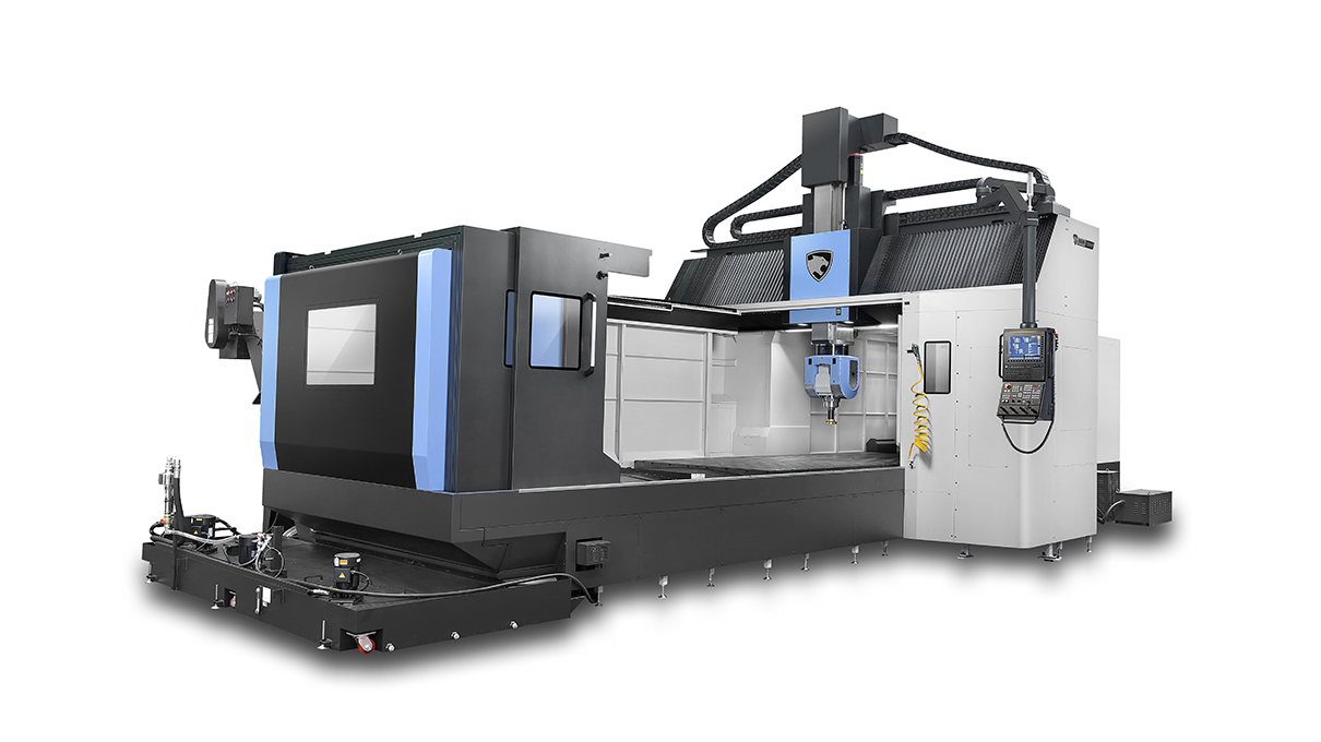

Multi-purpose double column machining center
The DBM U is a multi-purpose, double-column machining center that can perform 5-axis machining with the attachment of a universal head. It has a powerful spindle of over 1000Nm, a ram-type structure with an eight-sided support structure, and a double ball screw, which make it suitable for diverse machining applications. Moreover, to enhance precision, it incorporates a ball screw support bearing cooling system and adopts thermal deformation compensation as a standard, making it suitable for high-precision machining.
