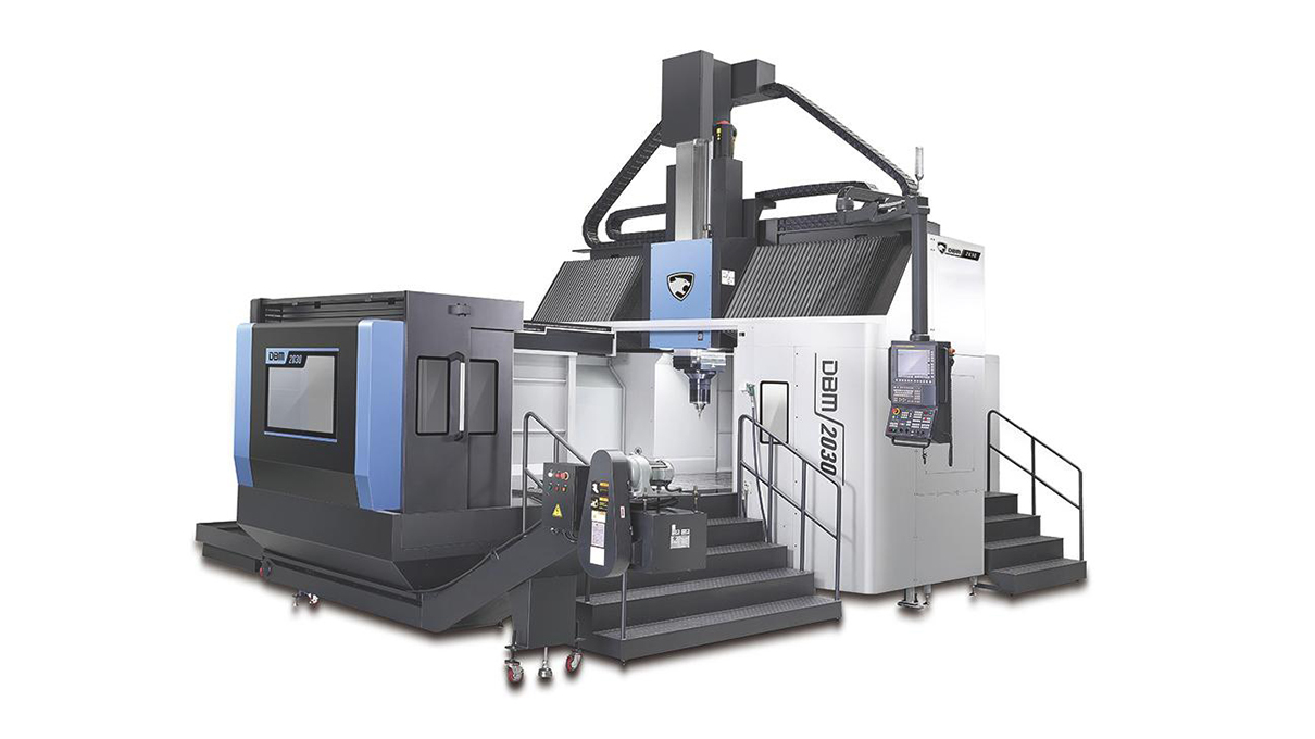

DBM 2030U
X-Axis Travel Distance
3250 mm
Y-Axis Travel Distance
DBM U series
Multi-purpose double column machining center
The DBM U is a multi-purpose, double-column machining center that can perform 5-axis machining with the attachment of a universal head. It has a powerful spindle of over 1000Nm, a ram-type structure with an eight-sided support structure, and a double ball screw, which make it suitable for diverse machining applications. Moreover, to enhance precision, it incorporates a ball screw support bearing cooling system and adopts thermal deformation compensation as a standard, making it suitable for high-precision machining.
￿ Broad range of machining capabilities￿
Auto-change attachments
￿ High-precision and high-speed mold machining performance￿
DSQ I/II/III functions
High-precision/ high-speed head attachments
￿ Convenient machining functions￿
Easy pattern cycles
Work load counter control
Automatic feed control
Table to spindle nose
Table Length Table Width
DBM 2030U
3250 mm 2500 mm 1000 mm
3000 mm 1500 mm
60 ea
DBM 2040U
4250 mm 2500 mm 1000 mm
4000 mm 1500 mm
60 ea
DBM 2540U
4250 mm 3000 mm 1000 mm
15000 r/min 146 N·m HSK-A100
4000 mm 2000 mm
60 ea
DBM 2550U
5250 mm 3000 mm 1000 mm
5000 mm 2000 mm
60 ea
DBM 3050U
5250 mm 3500 mm 1000 mm
5000 mm 2500 mm
60 ea
