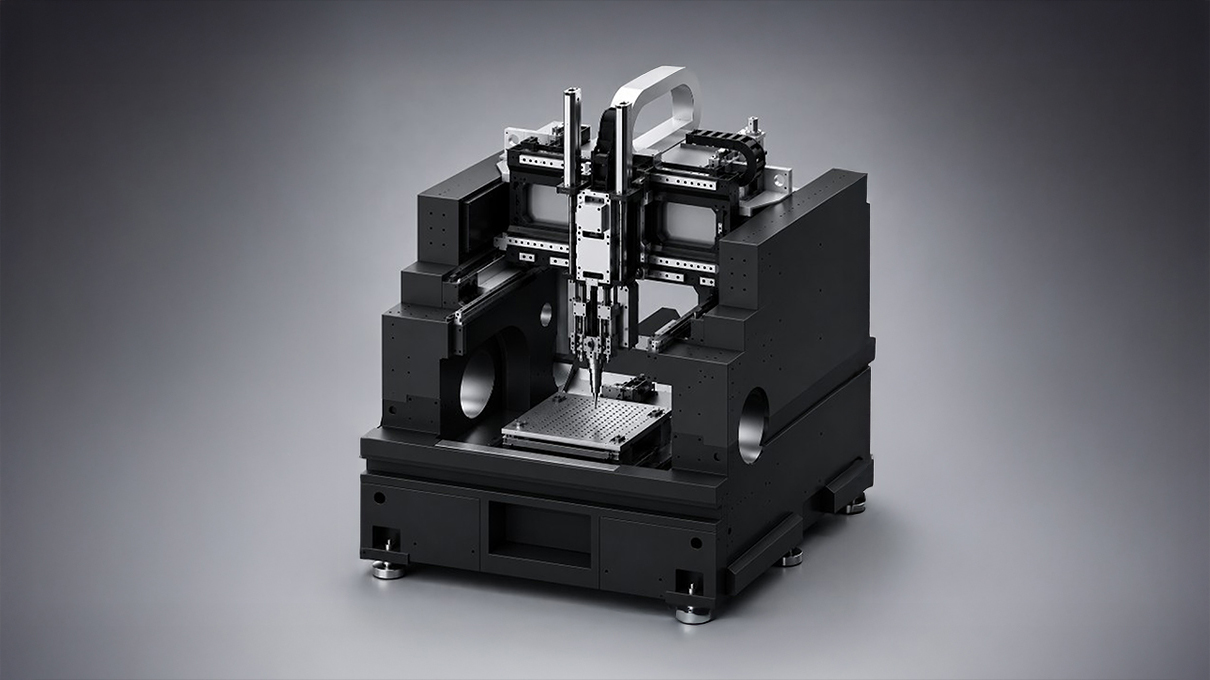

Processing Solution Combining the Advantages of Laser and Waterjet
A convergence solution that brings together the high productivity of laser processing and the stability of waterjet technology. By processing with a parallel laser beam, laser control is made more convenient, while the properties of water reduce heat-affected zones and maintain excellent surface quality.
Various Cutting Applications
￿ Convergence Processing Solution￿

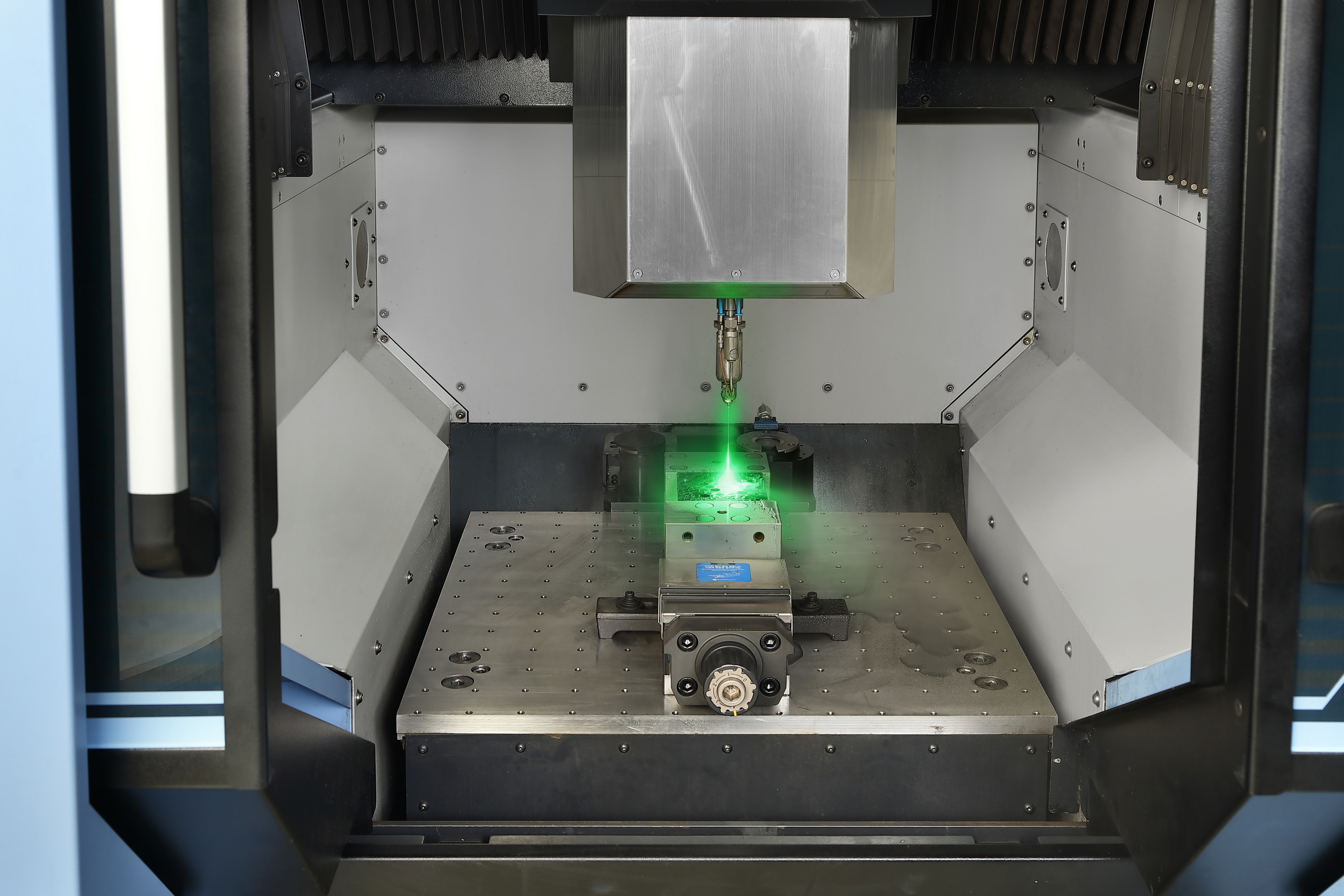

Combines the strengths of both laser processing and waterjet technology
Parallel laser beam guidance eliminates the need to control laser focal distance
Ultra-thin water stream cools the cut surface and removes burrs
Ideal solution for processing high-hardness and high-strength materials
￿ Superior Processing Capability￿
Large-format table for a wide working area
Capable of processing a diverse range of materials and complex geometries
￿ High-Precision Platform ￿
Delivers exceptional processing accuracy
High-precision, high-speed, stable acceleration/deceleration feed system
Mineral casting bed minimizes vibration and thermal displacement
