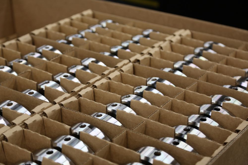

“It’s a defense project that we’ve engineered to the gills,” says Mike Budde, Owner of Budde Precision Machining. “We’re taking a twelve pound stainless steel disc and whittling it down to less than three pounds in eight and a half minutes. And we make 16,000 of them a year, all on one shift.”

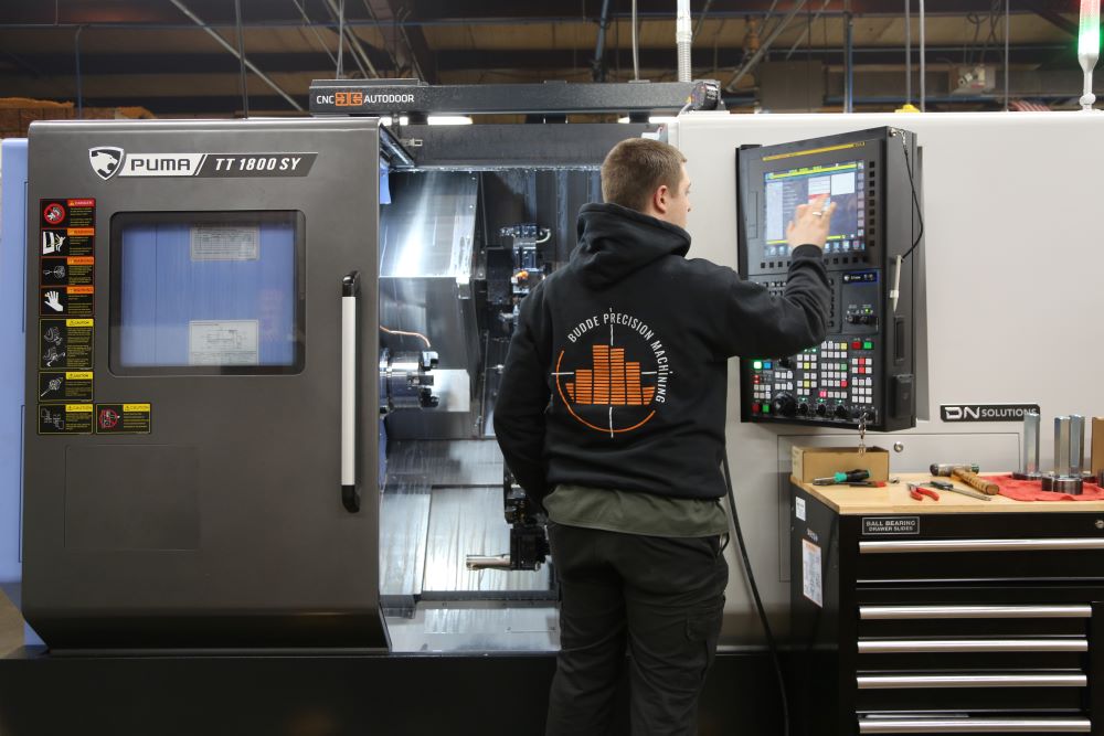

Budde’s weapon of choice for this application? The PUMA TT from DN Solutions.

With twin spindles, twin turrets and the ridiculously rigid boxway structure, the PUMA TT is a natural fit for complex and high precision jobs in difficult-to-machine materials. The Budde Precision team did their homework before purchasing the PUMA TT. They compared the machine to options from a wide range of machine tool brands and performance levels. “The PUMA TT has the features and performance of the high end brands at an amazing price point,” said Budde.
“We also looked at twin spindle, single turret machines as well,” said Budde. “While they probably would have done the job at a better price point, we invested in the additional capabilities of the PUMA TT for two reasons. The first is that we gained additional productivity to run a titanium prototype job in addition to the full stainless steel production job. Secondly, the twin turrets allow us to add redundant tooling to run lights out.”
Ellison Technologies, DN Solutions’ distributor, was instrumental in the selection of the PUMA TT for this application. “They helped us spec out the PUMA TT,” said Budde. “I know and trust our Sales Engineer, and I feel comfortable that our project is not going to fail with him involved. Period.”
Features and Performance
Budde Precision is capitalizing not only on the performance of the PUMA TT, but many of the standard features as well. “We’re utilizing in-machine probing, tool load monitoring, tool life management and more to really manage and control the cell and parts. Risk mitigation is what we’re after.”
One example: the stainless steel defense production part application referenced earlier involves plunging a 2.5” drill into stainless at a rapid rate. “Our concern was if we’re not paying attention, what’s going to happen?” said Budde. “Between the standard load monitoring and tool life management functions, we’ve dialed in the process. Any variance shuts the machine down and alerts us. This gives us the comfort level to flip off the lights and walk away while the machine makes parts.”
Additionally, in a 2 OP handoff application like this one, operators may be worried that the part is fully seated. “Traditionally, we would use air seat detection, which is an added system and cost,” said Budde. “But on the PUMA TT with this application, the combination of force sensing in the spindle and comparing the actual position to the expected position gives us the confidence that the part is fully seated. All of this came standard on our TT.”
The results? High productivity and unbeatable precision. “The lowest Cpk is above 10 for this application,” said Budde. “People don’t believe us when we tell them, but the results don’t lie.”
