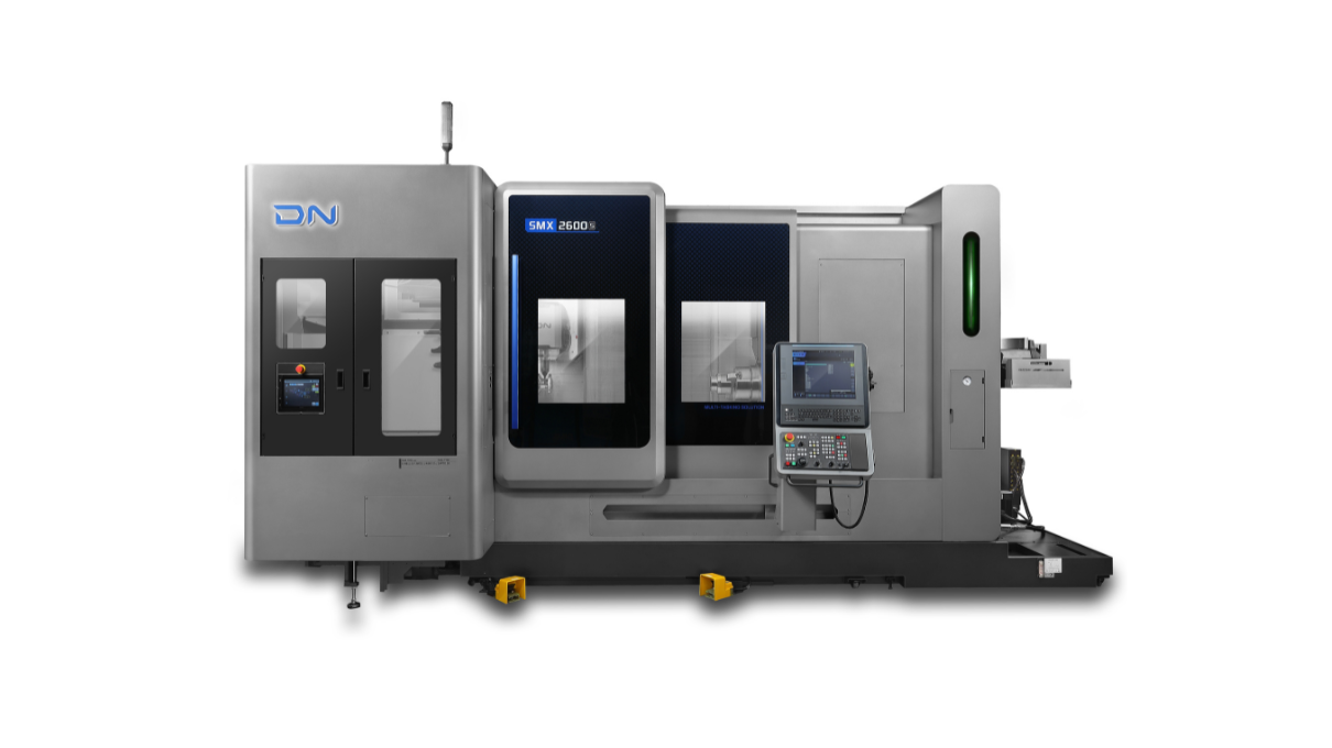

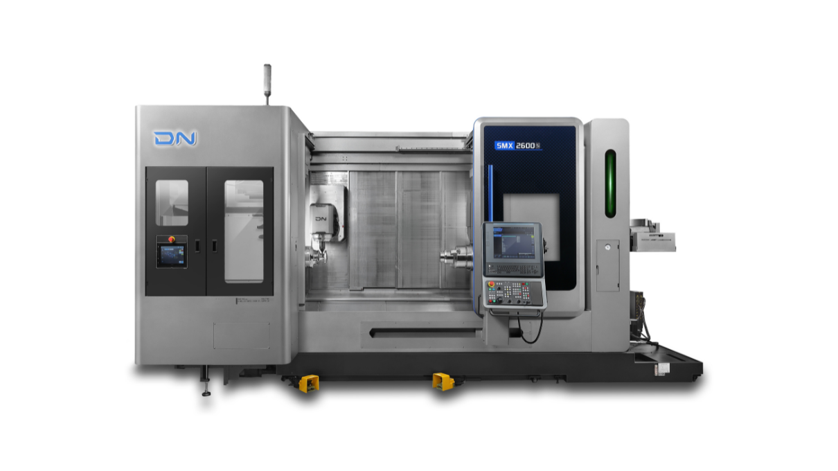

SMX2600S
660 mm
1540 mm
SMX series
High Performance Multi-axis Mill Turn Machine
With a total of nine axes on the SMX Series,
there is essentially no limit to what you can create. SMX machines are equipped with larger chuck sizes than PUMA MX machines but deliver the same high performance and impressive flexibility. These machines make all the difference.
Multitasking Capability
Shorter Setting Time
￿ Powerful multi-tasking capacity for higher productivity￿
Even higher multi-tasking capability is available from SMX machines through the combination of the left and right spindles, the B-axis milling function and a lower turret ideal- making the machines ideal for complex, high-precision machining.
Orthogonal structure maximizes machining space.
12 station high-rigidity servo turret ensures accurate and powerful cutting performance, and outstanding process reliability.
￿ Outstanding control delivers higher precision￿
0.0001-degree precision control function of B-axis
￿ and C-axis enables high-precision machining.
Minimized thermal displacement of the spindle and feed axis by the optimized cooling solution and smart thermal compensation ensure high precision even during long machining runs and extended use.
￿ Easy and convenient functions￿
Front located tool magazine and convenient ATC operation panel make it easy to change and replace tools, and monitor and check tool change operations.
Side-to-side movable swivelling operation panel with adjustable height settings. User friendly work guidance function.
