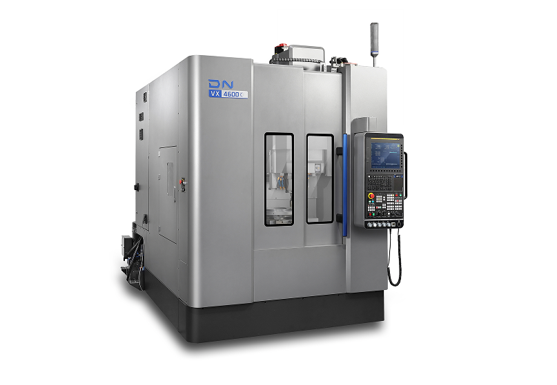

VX 4600C
X-Axis Travel Distance
Y-Axis Travel Distance
460 mm
VX Series
Gantry Machining Center for Semiconductor Material Processing
Optimized for machining SiC, ceramic, and quartz components, this machine delivers high rigidity and precision through a robust gantry structure and high-speed built-in spindle. A protected feed system enables stable long-term machining, while an optional vacuum unit further enhances quality and productivity.

Enhanced Durability with Feed System Protection Package
Bellows covers, ball screw covers, and double-wipers on the LM guides work together to effectively block fine chips from entering critical components. By protecting the core feed axis components, the machine maintains long-term machining quality with improved durability and reliability.
이송계 보호 패키지 이미지
설치공간 최소화 이미지
Minimal Footprint, Maximum Usability
At just 2m wide, one of the most compact in its class, the machine maximizes floor space efficiency, allowing more units per production line and optimizing your capital investment.
A wide door opening of up to 800mm improves operator access and setup convenience, keeping productivity high.
High-Rigidity Bridge Structure & Thermal Management as Standard
A high-rigidity bridge structure provides the structural rigidity needed for precise machining.
Thermal displacement correction for both the spindle and machine structure comes standard to maintain consistent quality.
Ball screw and spindle cooling systems are also included as standard to prevent thermal deformation.
