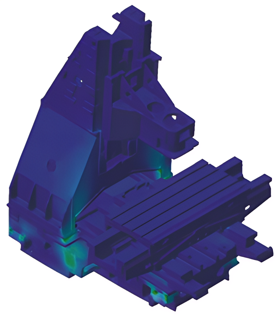

￿ Ensuring a highly rigid mechanical structure and maintaining stable precision￿
￿ Designed with an arched machine structure to minimize deformation even during heavy cutting￿
￿ Ensuring accuracy of machining dimensions and stability of high-speed rotation￿
Minimize thermal displacement and vibration by applying direct-type spindle
Minimize thermal displacement by using spindle head cooling system
Apply 2-sided restraint spindle
