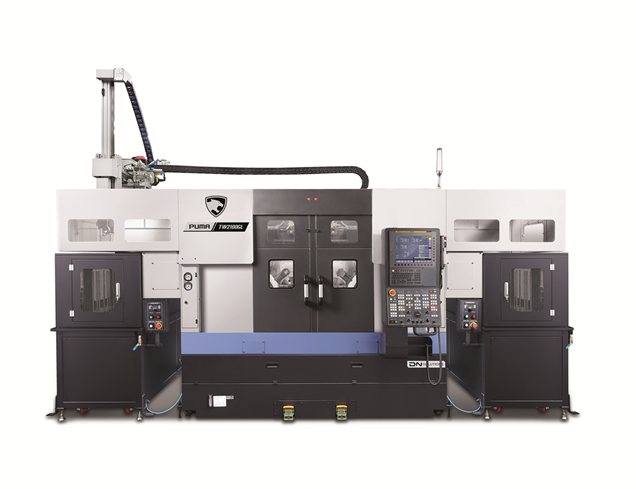

PUMA TW series
Twin-Turret, Twin-Spindle HTC with Forward-Facing Chucks
The PUMA TW features twin parallel spindles and twin turrets with live tooling
￿ which makes it ideal for machining automotive ring gear or clutch boss components.
Easier Automation
￿ Superior Productivity￿
Unrivalled productivity due to minimal idle spindle time with minimized gantry loader handling time and increased indexing speed with servo-driven turrets.
￿ Superior Machining Performance￿
3-Axis Turret Size Enlargement Option
PUMA TW2600M: BMT 65P option :
Motor power 10kW, Torque 63.7N.m, Max. Tap size Ø20mm
￿ High Speed Gantry Loader￿
Gantry loader handling time (Enter->Change Work->Exit)
PUMA TW/TS2100-GL: 5.7s
PUMA TW/TS2600-GL: 7.9s
￿ Improved User Convenience￿
Built-in Doosan Loader Guidance software for easy and convenient Gantry Loader operation and machine maintenance.
No. of tool station Rotary Tool r/min
PUMA TW2100
8 inch 240 mm 128 mm
24 m/min 24 m/min 135 mm 160 mm
4500 r/min 15/11 kW 127 N·m
8 ea
2030 mm 2278 mm 2098 mm 4650 kg
PUMA TW2100M
10 ea 6000 r/min
2030 mm 2278 mm 2098 mm 4700 kg
PUMA TW2600
10 inch 360 mm 170 mm
24 m/min 24 m/min 190 mm 180 mm
3500 r/min 18.5 kW 201 N·m
2520 mm 2150 mm 2061 mm 7200 kg
PUMA TW2600M
10 ea 5000 r/min
2520 mm 2150 mm 2061 mm 7300 kg
