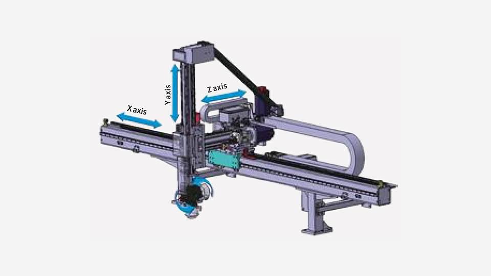

Built-in Doosan Loader Guidance software for easy and convenient Gantry Loader operation and machine maintenance.

PUMA TW 2100-GL
8 inch 130 mm 80 mm
24 m/min 24 m/min 135 mm 160 mm
4500 r/min 15/11 kW 127 N-m
8 ea
2030 mm 2921 mm 2098 mm 5200 kg
