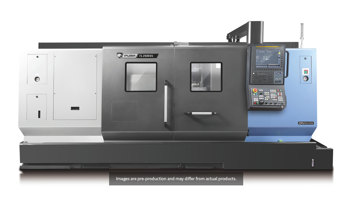

PUMA TL2000L
370 mm
PUMA TL series
MULTI-TURRET
Equipped with upper and lower turrets, the PUMA TL Series is perfect for shaft work such as camshafts and crankshafts where simultaneous 4-axis work is required.
Multitasking Capability
12+8 TURRET STATIONS
The PUMA TL multi-turret turning center allows parallel
￿ processing of components. This reduces cycle times and
￿ delivers increased productivity.
One machine.
The PUMA TL multi-turret turning center allows parallel processing of components. This reduces cycle times, unlike single-turret machines.
￿CHILLED SPINDLE￿
Built-in endurance.
The robust triangular frame on the PUMA TL houses a powerful and versatile spindle motor. From precise finishing to high powered metal removal using both turrets at the same time, it’s built to thrive in your production environment.
UNFLINCHING PRODUCTION￿
A new level of performance and capability.
The widely spaced guideways and heavy duty tailstock design combine to give you the rigidity you need. The tailstock is positioned by a drive bar that engages with the carriage, and it possesses a 120 mm quill travel and 100 mm quill diameter.
No. of tool station Rotary Tool r/min
PUMA TL2000
8 inch 370/240 mm 600 mm
20 m/min 24 m/min 250 mm 650 mm
5000 r/min 22 kW 477 N·m
12/8 ea
3250 mm 1930 mm 2118 mm 7200 kg
PUMA TL2000L
8 inch 370 mm 1000 mm
20 m/min 24 m/min 250 mm 1050 mm
12/8 ea
3900 mm 1930 mm 2144 mm 8400 kg
PUMA TL2000LM
8 inch 350/240 mm 1000 mm
12/8 ea 5000 r/min
PUMA TL2000M
8 inch 350 mm 600 mm
12/8 ea 5000 r/min
PUMA TL2500
10 inch 370/240 mm 600 mm
4000 r/min 26 kW 433 N·m
12/8 ea
3250 mm 1930 mm 2118 mm 7300 kg
PUMA TL2500L
10 inch 370/240 mm 1000 mm
12/8 ea
3900 mm 1930 mm 2144 mm 8500 kg
PUMA TL2500XL
10 inch 370 / 240 mm 1250 mm
20 m/min 24 m/min 250 mm 1300 mm
12/8 ea
4510 mm 2115 mm 2630 mm 9600 kg
PUMA TL2500LM
10 inch 350/240 mm 1000 mm
12/8 ea 5000 r/min
PUMA TL2500XLM
10 inch 350 / 240 mm 1250 mm
12/8 ea 5000 r/min
4510 mm 2115 mm 2630 mm 9700 kg
