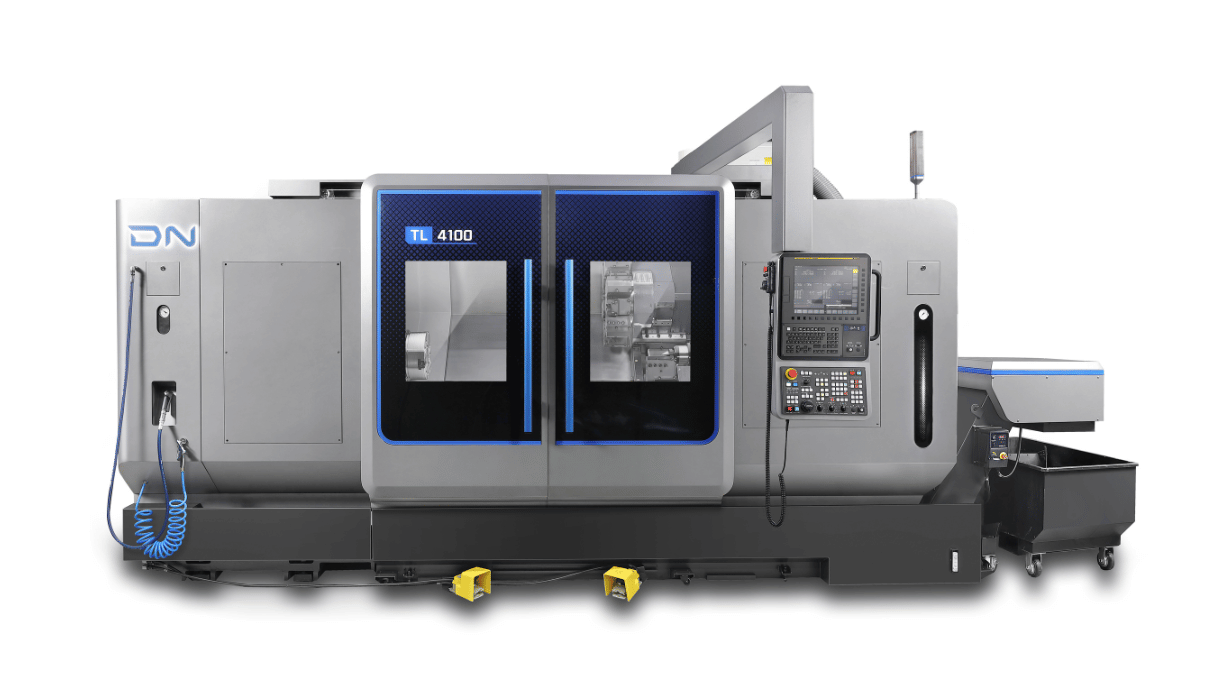

Equipped with upper and lower turrets, the PUMA TL Series is perfect for shaft work such as camshafts and crankshafts where simultaneous 4-axis work is required.
Multitasking Capability
12+8 TURRET STATIONS
The PUMA TL multi-turret turning center allows parallel
￿ processing of components. This reduces cycle times and
￿ delivers increased productivity.
One machine.
The PUMA TL multi-turret turning center allows parallel processing of components. This reduces cycle times, unlike single-turret machines.
￿CHILLED SPINDLE￿
Built-in endurance.
The robust triangular frame on the PUMA TL houses a powerful and versatile spindle motor. From precise finishing to high powered metal removal using both turrets at the same time, it’s built to thrive in your production environment.
UNFLINCHING PRODUCTION￿
A new level of performance and capability.
The widely spaced guideways and heavy duty tailstock design combine to give you the rigidity you need. The tailstock is positioned by a drive bar that engages with the carriage, and it possesses a 120 mm quill travel and 100 mm quill diameter.
