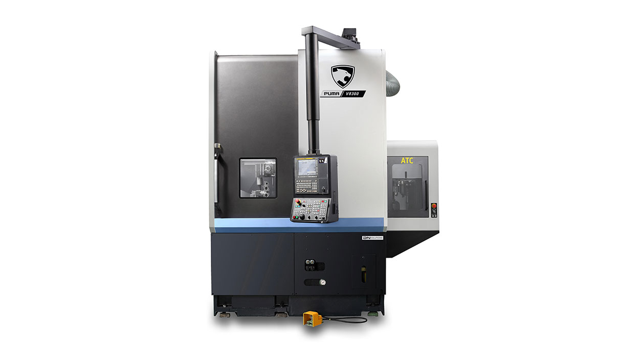

The PUMA V8300 Series is a step up from the V400 in terms of size. With a hefty max turning diameter, accepting a range of chucks from 381 mm up to 610 mm, it makes mincemeat of bigger workpieces.
￿NONSTOP MACHINING￿
The PUMA V8300 will go all day.
Killer combo right here: Because of its heavy duty box guideway bed and a powerful 37 kW spindle with 2,592 Nm of torque, machining performance on the V8300 is maximized. Option a second spindle to kick the performance up even higher.
￿FAST & RELIABLE￿
Let’s talk turrets.
The servo-driven turret on the Puma V8300 is speedy and it won’t let you down. It sports 12 stations and an optional milling turret that has a three-piece curved coupling clamp with cross roller way support.
￿BELLS & WHISTLES
The V8300 is packed with bonus features.
The slant-type base and improved flushing function allow for enhanced chip disposal. Ergonomic OP panel design with adjustable height makes operation a piece of cake. You can also option a 12-tool ATC for jobs that require longer tools that would normally interfere with the workpiece.
