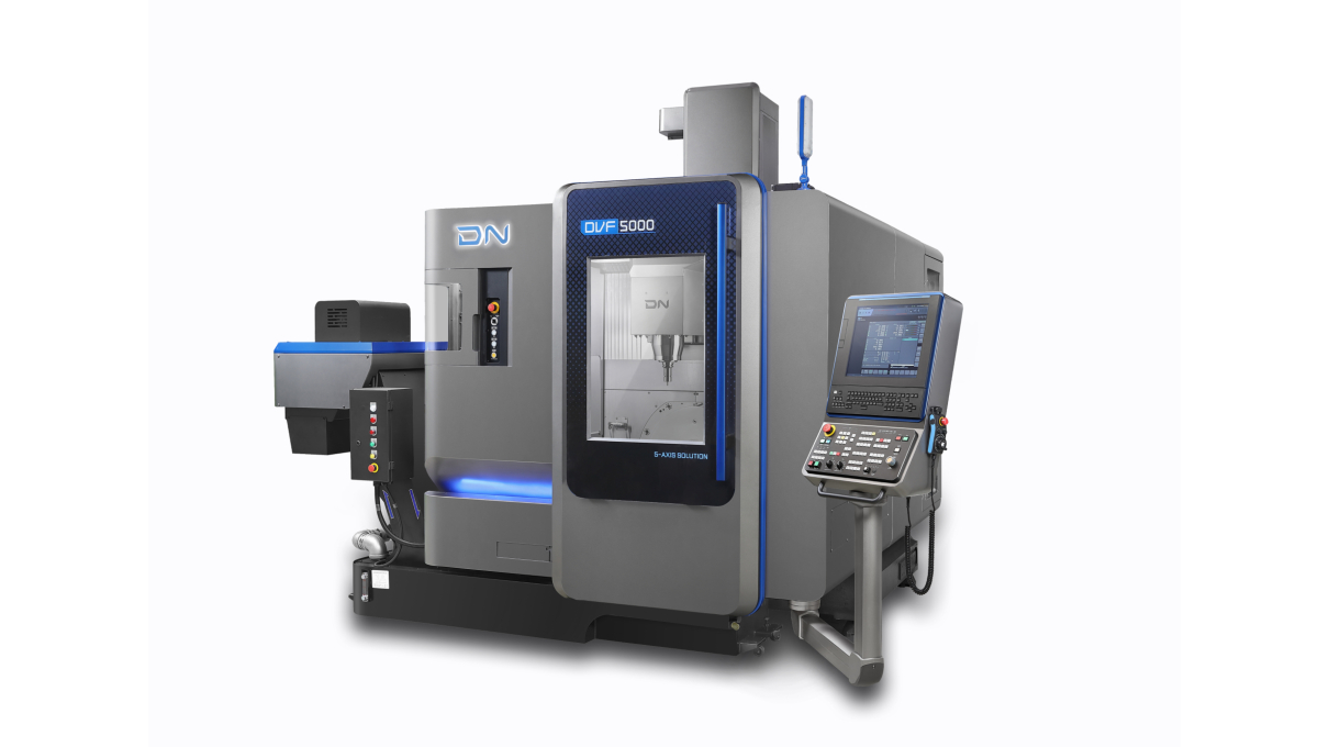

DVF 5000 5-axis machining centres are designed for component manufacturers looking to machine high-precision, complex parts in one hit. Equipped with leading edge technology and supplied ‘automation- ready’, these machines will take your productivity and performance to a whole new level.
Multitasking Capability
￿ Solutions for complex shapes￿
12000 / 18000 r/min high-speed spindle
2-axis tilting table from Ø400 mm to Ø800
Table turning function : DVF 6500T / DVF 8000T
High torque spindle of 426 N.m : DVF 8000T/50
￿ High-precision￿
Tool length measurement probe is provided as standard.
Integrated thermal compensation systems for spindle and structure
Spindle cooling provided as standard
￿ User-friendly machine￿
The tool magazine is able to hold up to 120 tools and the multi-pallet system facilitates unmanned running.
Compact automation systems are available (AWC, RPS, LPS)
