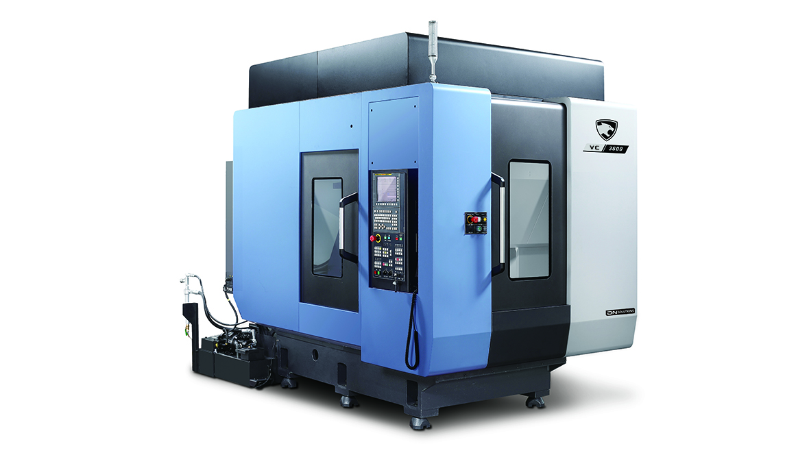

VC series machining centers have a twin pallet configuration. Their design enables continuous and seamless machining of components - doubling output and significantly increasing productivity.
Video
VC 4000D-2SP
High-rigidity and column-moving structure
High-rigidity casting and machine structure are excellent for damping and absorbing vibrations.
High productivity by applying the spindle directly
(different from the spindle taper)
VC 3600 : ISO #40
VC 3600/30 : ISO #30
High-speed Automatic Pallet Changer
The twin table equipped with automatic pallet indexing enables
fast and accurate table positioning, improved productivity and minimal machine idle time.
