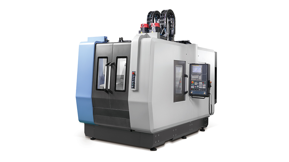

The XC 4000-2SP twin-spindle vertical machining center is designed for high volume parts production. With two 12000r/min directly-connected spindles, the machine provides best-in-class high-speed machining productivity. The use of a mineral cast bed helps maintain stability and precision over long periods of time. The machine is also suitable for use with automated part-loading systems for unmanned running.
Structure optimized for high precision and productivity
A mineral casting bed helps ensure high rapids and acceleration/deceleration rates.
To optimize durability and stiffness dual ball screws are used.
High-rigidity·High-precision
Tool magazines are positioned at the base of the traveling column to ensure high-speed machining performance. (Tool storage capacity: 24*2ea / C-T-C : 3.8 sec)
Automatic door is optimized for high-speed tool change (LM & Pneumatic cylinder driven)
