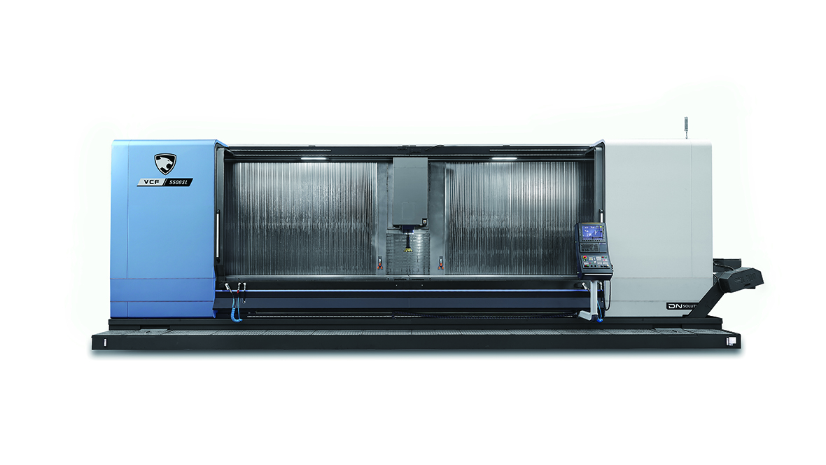

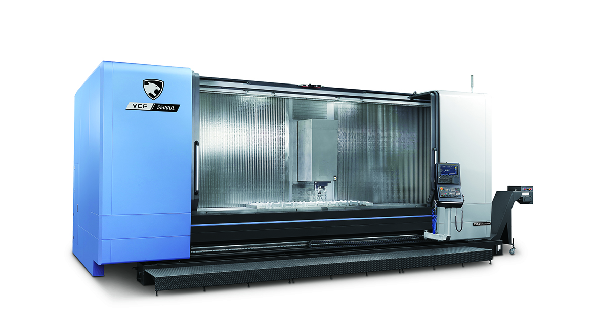

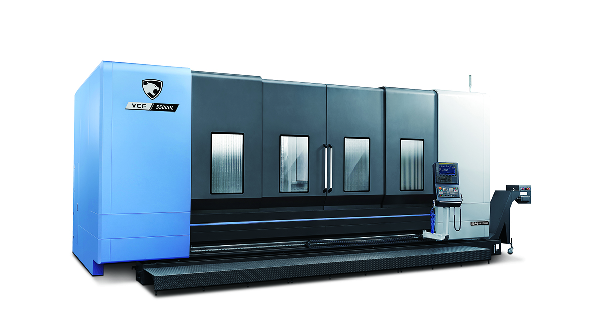

VCF 5500UL
5000 mm
570 mm
46 m/min
18.5/11 kW
117.8 N·m
5600 mm
6000 kg
8410 mm
3420 mm
3571 mm
23000 kg

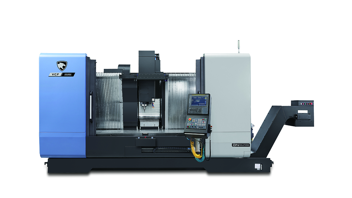

VCF 5500L
2200 mm
510 mm
42 m/min
42 m/min
42 m/min
18.5 kW
117.8 N·m
3580 mm
2000 kg
4590 mm
3030 mm
2950 mm
12000 kg

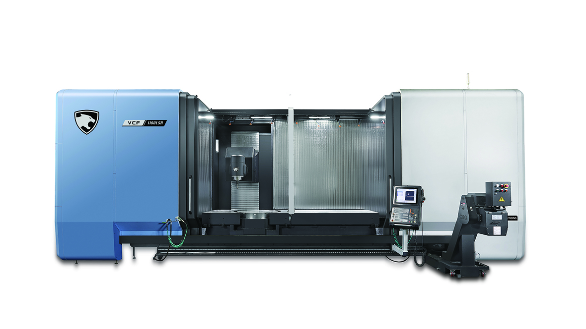

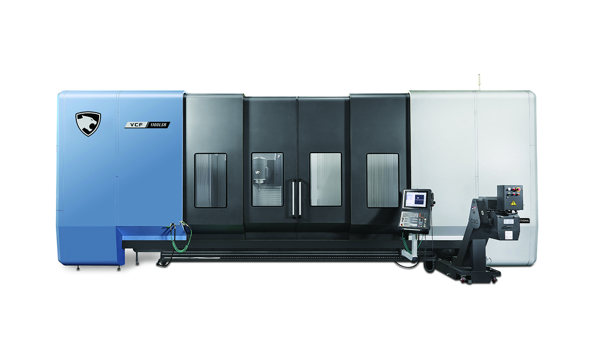

VCF 1100LSR
4000 mm
1100 mm
10000 r/min
37 kW
302 N·m
ISO #50
1050 mm
2000 kg
6045 mm
3977 mm
10170 mm
39000 kg
