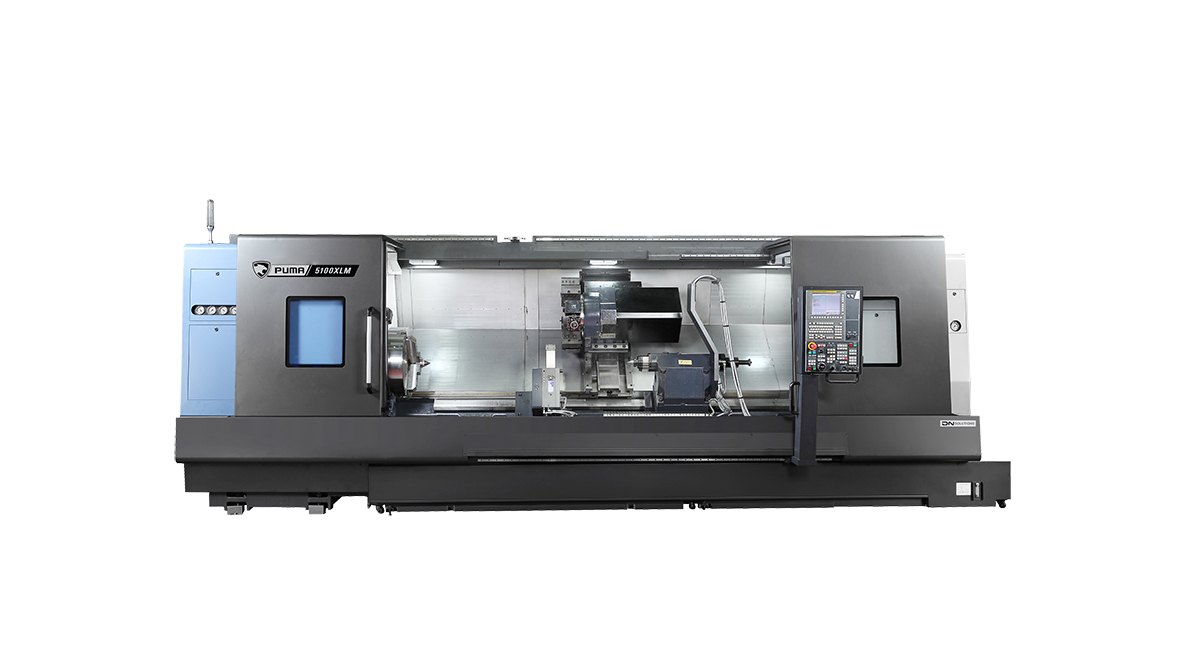

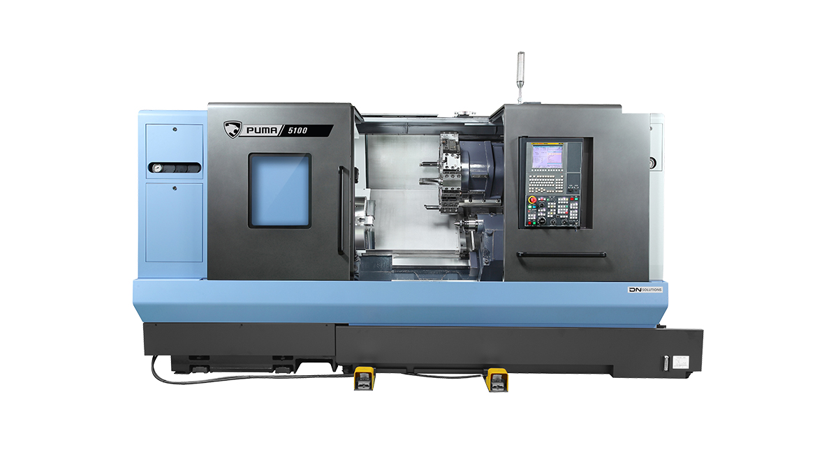

The newly designed PUMA 4100/5100 horizontal turning centers
have specific features that make component manufacturers’ jobs a lot easier to perform,especially if they are machining parts for the oil and gas industry.
Various Cutting Applications
Single setup for machining large complex parts
Maximum productivity can be achieved with the 200mm Y axis stroke
Boasting large machining areas and equipped with a range of productivity- and precision-enhancing technologies, PUMA 4100/5100 series are perfect for machining large, complex work pieces
Max. turning length : 5m
Max. turning diameter : 900 mm
Ideal for heavy-duty cutting of large parts
Machining Solution for wide range of pipes
Wide range of solutions to improve threading performance and reduce failure ratios
Ø375 mm maximum spindle through hole diameter makes it ideal for turning large diameter pipes
