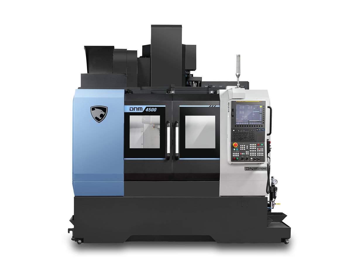

DNM 4500 4세대
800 mm 450 mm 510 mm
42 m/min 42 m/min 36 m/min
8000 r/min 18.5 kW 117.8 N-m ISO #40
1000 mm 450 mm 600 kg
2200 mm 2980 mm 2835 mm 5000 kg

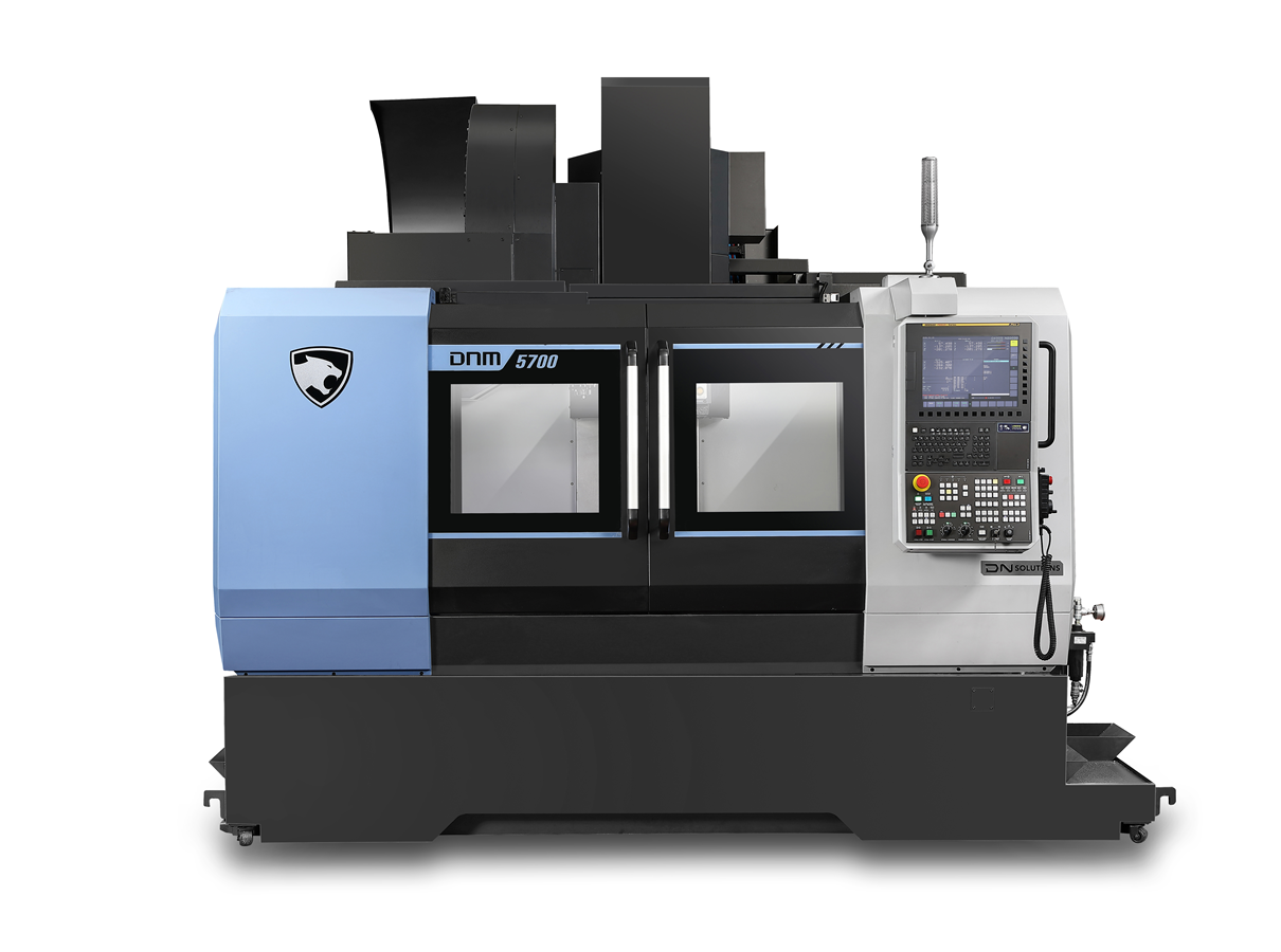

DNM 5700 4세대
1050 mm 570 mm 510 mm
1300 mm 570 mm 1000 kg
2470 mm 2980 mm 3320 mm 6500 kg
