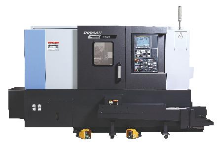

Turning Center
Single Turret Horizontal With Milling
PUMA 2100/2600/3100 series
8"~12" High-performance Y-axis Horizontal Turning Center
118
If you are machining simple, straightforward parts through to high-precision, complex components made from difficult-to-machine materials
the PUMA 2100/2600/3100 series is your ‘go-to’ turning center. The machines have been designed with single-set up efficiency and accuracy in mind.
Shortened Machining Time
Multitasking Capability
High performance
Upgraded structural rigidity
Reduced vibration and ensures dynamic rigidity
Powerful and precise machining
Y-axis complex machining
Y-axis capability enables the machining of complex shapes and features (PUMA 2100/2600Y models).
Improved user-friendly functionality
User-friendly operation panel
Simple maintenance function
