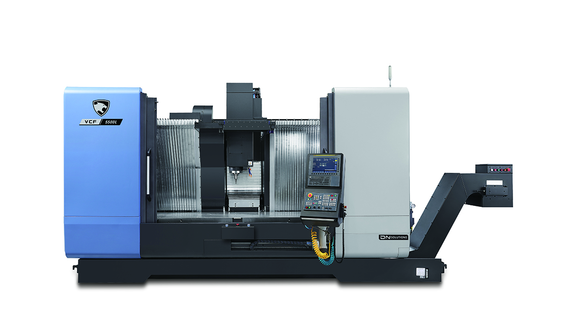

Equipped with a 10-foot (3 metre) X-axis travel and a wide array of options,
the VCF Series provides manufacturers with a innovative and inspirational way to achieve multi-purpose productivity from a single machine.
Spatial efficiency
Shorter Setting Time
High performance and high rigidity B-Axis structure
The high-rigidity Roller Gear Cam structure with the machine’s B-axis provides excellent cutting performance and durability.
Enhanced productivity across a wide range of applications
Inclusion of a rotary table, a center partition and a pick-up magazine – all help the user to more than double their machining efficiencies.
Multi-purpose machine tool capable of simultaneous machining using 3- to 5-axes
Simultaneous machining operation from 3- to 5-axes (based on X-axis of 2m and 3m): a real multi-purpose machine.
